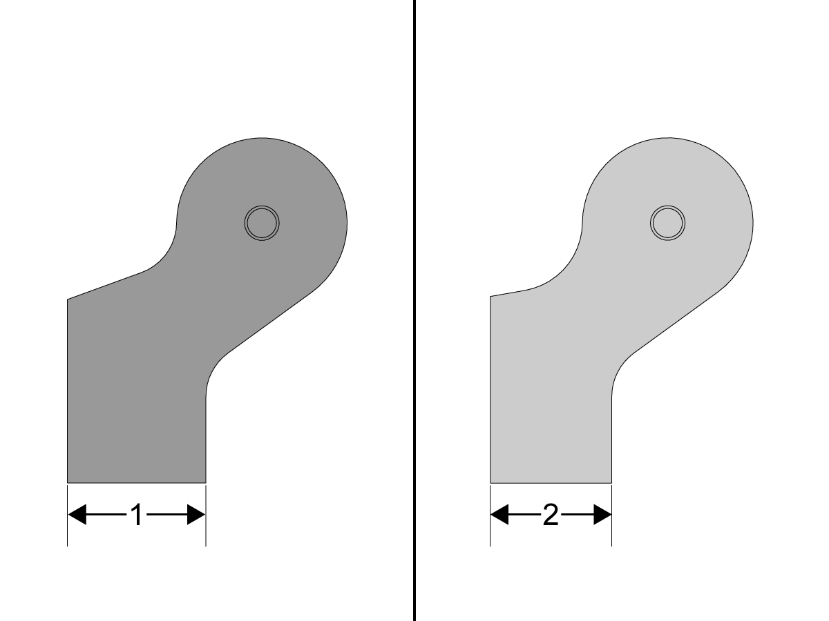

Use the image to determine if your machine has the old mount, the old mount will have a thickness of 2 inches [1] and the new one will have a thickness of 1.75 inches [2].

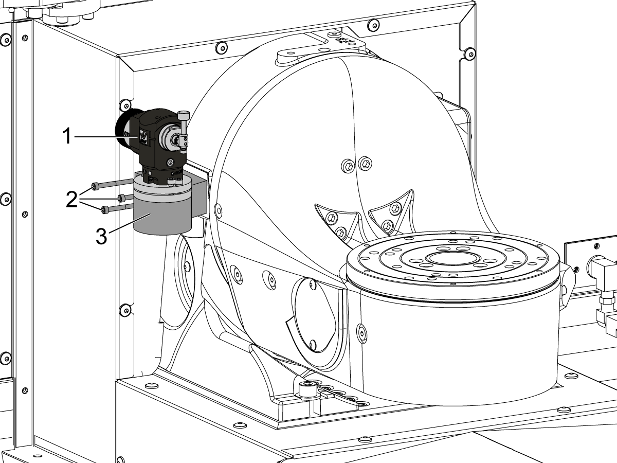

Remove the OTS Probe [1] and the old probe mount [2] and screws [3].

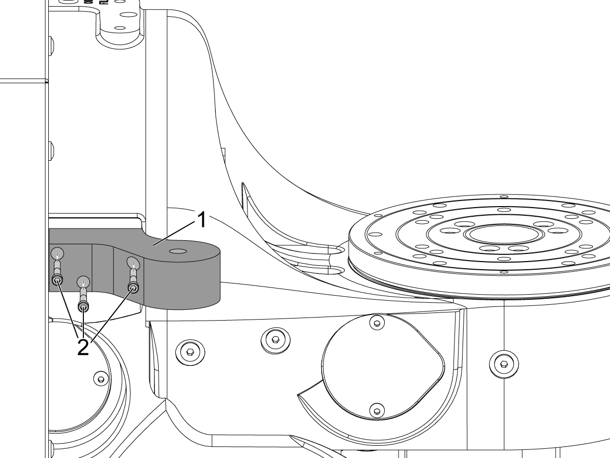

Install the new probe mount [1] and screws [2].
Reattach the OTS Probe [1] to the new probe mount.
