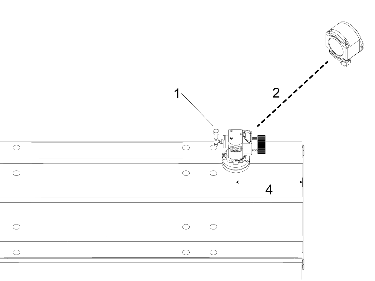

Determine position of tool probe:
Note: Ideal tool probe positioning may vary depending on the size of tools, the size of your workpiece, and your tool paths. Ensure that your tool probe will not be crashed into during normal operations.
Tool probe should be oriented with the stylus [1] facing towards the machine spindle. The data transmission window should be pointed towards the OMI [2]. The angle of the window can be adjusted later.
On UMC machines, the tool probe should be placed on the tool probe stand [3]. For other machines, the tool probe should be placed on the table. It should be located a minimum of 4 inches (10 cm) from the edge of the table [4].
NOTE: Machines with TRT rotaries.  Refer to the TRT - Probe Riser Block - Installation procedure.
Install the tool probe to the table:
Loosen the (6) set screws [1] around the probe body.
Remove the base [2] from the probe body.
Use a 3/8" - 16 x 1 socket head cap screw [3] to anchor the base to the machine table.
Torque the mounting bolt to 25 ft lbs
Place the probe body on the base.
Snug the (4) base mount set screws [4].
Snug the (2) base rotation set screws [5].
 Note: Test that your largest diameter tools can be touched off against the tool probe before proceeding to the next step.

Align the probe with the OMI receiver:
Loosen the set screw [3] beneath the stylus.
Turn the probe body so that the data transmission window [2] points at the OMI receiver [1].
Snug the set screw.
