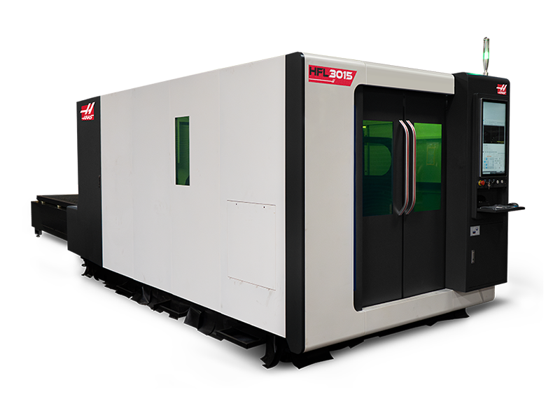

Haas Fiber Laser Cutting Machine
  • 6 kW fiber laser
  • 120" x 60" (3050 x 1530 mm) work area
  • High-speed autofocus sensor head
  • Programmable assist gas ports (air, oxygen, nitrogen)
  • Dual automatic shuttle tables
  • Windows-based laser controller w/large touchscreen
  • CypCut laser programming software with nesting capability
  • Internal and external cameras for process/safety monitoring
  • Remote pendant
  • Full enclosure for safety and protection
  • Heat-isolated machine bed for stability
  • Negative pressure dust removal system
See Available Stock
Current Lead Time
Compare Machines
EXPLORE ALL INVENTORY
Contact Distributor
The Haas HFL-3015-6-CE is a fully enclosed 6 kW CNC fiber laser cutting machine with a high-speed autofocus sensor head and a large work area. The unit has dual shuttle tables that exchange automatically, allowing raw material and finished parts to be loaded and unloaded on one table, while the other table is in the machine, providing near continuous operation.
The 6 kW fiber laser cutting head is optimized to provide excellent cut quality and high efficiency, and features automatic focusing to reduce set-up time and increase accuracy. The laser easily cuts a variety of metals, including carbon steel, stainless steel, aluminum alloy, brass, copper, and even titanium alloy.
Haas HFL Series lasers carry a full 1-year warranty – parts and labor – with support by your local Haas Factory Outlet.
    MATERIAL CUTTING RANGE
Material SAE Metric
Carbon Steel 0.016" - 0.87" 0.4 - 22 mm
Stainless Steel 0.016" - 0.63" 0.4 - 16 mm
Aluminum 0.016" - 0.47" 0.4 - 12 mm
NOTE: Maximum cutting range varies with material thickness, type of assist gas used, part geometry, cutting speeds, and desired cut quality.

    STANDARD CONFIGURATION
    LASER
    6 kW Fiber Laser
    High-Speed Sensor Head
    Automatic Focusing Lens
    Multi-Protection Lens
    Drawer-Type Lens Holder
    Dual Water-Cooling Circuits
    WORK PLATFORM
    120" x 60" (3050 x 1530 mm) Work Area
    Dual Automatic Shuttle Tables
    CONTROL
    Intelligent CNC Operating System w/Touchscreen
    CypCut Laser Cutting System w/Nesting Capability
    Remote Pendant
    PRODUCT FEATURES
    Multiple Programmable Assist Gas Ports (air, oxygen, nitrogen)
    Visual Monitoring System for Safety, Internal and External
    Negative-Pressure Zonal Dust Removal System
    Sealed Base for Smoke-Free Cutting
    Heavy-Duty Heat-Isolated Bed
    Specification SAE Metric
    Work Area (length x width) 122.8" x 62.2" 3120 x 1580 mm
    X-Axis Travel 60" 1530 mm
    Y-Axis Travel 120"  3050 mm
    Z-Axis Travel 8.7" 220 mm
    X/Y Positioning Accuracy ±0.002" ±0.05 mm
    X/Y Repeatability ±0.0008" ±0.02 mm
    Maximum Speed 5118 ipm 130 m/min
    Maximum Acceleration 1.2G 1.2G
    Maximum Load on Table 2425 lb 1100 kg
    Machine Weight 11,772 lb 5340 kg
    Dimensions (length x width x height) 335.4" x 89.4" x 85.8" 8520 x 2270 x 2180 mm
    Power (with included transformer) 3-phase 208V or 380V (Delta or Wye) 3-phase 208V or 380V (Delta or Wye)
    Machine FLA 139A @ 208V, 76A @ 380V 139A @ 208V, 76A @ 380V
    Shipping Specifications SAE Metric
    Machine + Pallet Station Dimensions 217.3" x 90.6" x 87.4" 5520 x 2300 x 2220 mm
    Dust Collector Dimensions 64.6" x 57.9" x 123.6" 1640 x 1470 x 3140 mm
    Accessories Pallet Dimensions 59.8" x 90.6" x 59.1" 1520 x 2300 x 1500 mm
    Machine + Pallet Station Weight 13,779 lb 6250 kg
    Dust Collector Weight 2425 lb 1100 kg
    Accessories Pallet Weight 2645 lb 1200 kg
