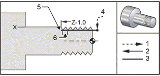

Service Home G92 Threading Cycle (Group 01)
F( E) - Feed rate, the lead of the thread
* I - Optional distance and direction of X Axis taper, radius
* Q - Start Thread Angle
* U - X-axis incremental distance to target, diameter
* W - Z-axis incremental distance to target
X - X-axis absolute location of target
Z - Z-axis absolute location of target
* indicates optional
Programming Notes:
  • Setting 95/Setting 96 determine chamfer size/angle. M23/M24 turn chamfering on/off.
  • G92 is used for simple threading, however, multiple passes for threading are possible by specifying the X locations of additional passes. Straight threads are made by specifying X, Z, and F. By adding an I value, a pipe or taper thread is cut. The amount of taper is referenced from the target. That is, I is added to the value of X at the target. At the end of the thread, an automatic chamfer is cut before reaching the target; default for this chamfer is one thread at 45 degrees. These values can be changed with Setting 95 and Setting 96.
  • During incremental programming, the sign of the number following the U and W variables depends on the direction of the tool path. For example, if the direction of a path along the X-axis is negative, the value of U is negative.
G92 Threading Cycle: [1] Rapid, [2] Feed, [3] Programmed path, [4] Start position, [5] Minor diameter, [6] 1/Threads per inch = Feed per revolution (Inch formula; F = lead of thread) .
