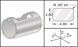

This G code translates all programmed motion occurring in a specified linear axis into the equivalent motion along the surface of a cylinder (as attached to a rotary axis) as shown in the following figure. It is a Group 0 G code, but its default operation is subject to Setting 56 (M30 Restores Default G). The G107 command is used to either activate or deactivate cylindrical mapping.

Cylindrical Mapping Example
While R is suitable for defining the radius, it is recommended that I, J and K are used for more complex G02 and G03 programming.
O61071 (G107 CYLINDRICAL MAPPING) ;
(G54 X0 Y0 is in center of rectangular slot) ;
(Z0 is on highest point of cylindrical surface) ;
(T1 is a .625 in. dia endmill) ;
