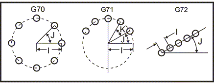

I - Distance between holes
* J - Angle of line (degrees CCW from horizontal)
L - Number of holes
*indicates optional
This non-modal G code drills L number of holes in a straight line at the specified angle. It operates similarly to G70. For a G72 to work correctly, a canned cycle must be active so that at each position, a drill or tap function is performed.
G70, G71, and G72 Bolt Holes: [I] Radius of bolt circle (G70, G71), or distance between holes (G72), [J] Starting angle from the 3 o clock position, [K] Angular spacing between holes, [L] Number of holes.
Rules for Bolt Pattern Canned Cycles
  1. Place the tool at the center of the bolt pattern (for G70 or G71), or at the starting hole location (for G72), before the canned cycle execution.
  2. The J code is the angular starting position and is always 0 to 360 degrees counterclockwise from the three o clock position.
  3. For G70 and G71 cycles, put an L0 on the initial canned cycle line to skip drilling at the center of the hole pattern. You can also turn off Setting 28 to prevent a hole from being drilled at the initial X/Y position. Refer to 28 - Can Cycle No Linear Axes for more information on Setting 28.
