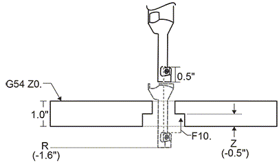

In addition to boring the hole, this cycle shifts the X and Y Axis before and after the cut, to clear the tool while it enters and exits the workpiece (refer to G76 for an example of a shift move). Setting 27 defines the shift direction. If you do not specify a Q value, the control uses the optional I and J values to determine the shift direction and distance.G77 Back Boring Canned Cycle Example

G77 Approximate Toolpath Example. This example shows the entrance motion only. Dimensions are not to scale.
NOTE: For this example, the "top" of the workpiece is the surface defined as Z0. in the current work offset. The "bottom" of the workpiece is the opposite surface.
In this example, when the tool reaches the R depth, it then moves 0.1" in X (the Q value and Setting 27 define this movement; in this example, Setting 27 is X+). The tool then feeds to the Z value at the given feedrate. When the cut is finished, the tool shifts back toward the center of the hole and retracts out of it. The cycle repeats at the next commanded position until the G80 command.
NOTE: The R value is negative, and it must go past the bottom of the part for clearance.
NOTE: The Z value is commanded from the active Z work offset.
NOTE: You do not need to command an initial point return (G98) after a G77 cycle;
the control assumes this automatically.
