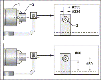

These settings are used to define the displacement and size of the ATP. These four settings (59, 60, 333, 334) specify the travel distance and direction from where the probe is triggered to where the actual sensed surface is located.
For more information on how to calibrate the ATP refer to the Automatic Tool Presetter (ATP) - Calibration section.
These settings are used by the G31 code. The values entered for each setting must be positive numbers.
Macros can be used to access these settings, see the Macro section for more information.
59/60/333/334 Tool Probe Offset:[1] Chuck, [2] Part, [3] Probe, [#59] Setting 59, [#60] Setting 60, [#333] Setting 333, [#334] Setting 334,
