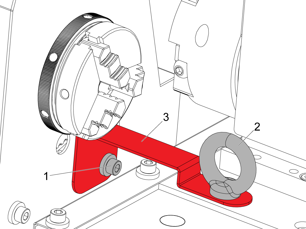

Shipping Bracket
Unscrew the screw with a 4 mm Allen wrench and remove the washer [1] from the spindle head, then unscrew the eye bolt [2] from the saddle to remove the shipping bracket [3].
After the shipping bracket has been removed, put the screw and washer [1] back on the spindle head as these also hold the spindle head's sheet metal in place.
