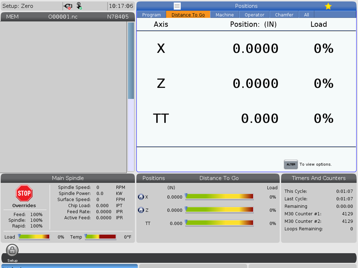

  • 6.1 power up/zero return
  • 6.2 Spindle Chuck
  • 6.3 Tool Turret
  • 6.4 Z Axis Travel limits Setting 315
Desktop Lathe Power Up / Zero Return
After the machine is powered on cycle the door and the [EMERGENCY STOP] button. Then press [POWER UP].
The zero return sequence follows as such:
  1. Z - Axis
  2. X - Axis
  3. TT - Axis
NOTE: When all the axis are at home position an Home icon will be displayed next to the axis.
