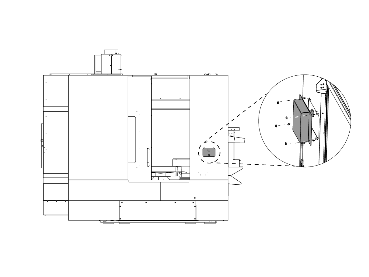

Install Remote Switch Boxes
Remote Switch Boxes are secured inside the enclosure for the corresponding location.
Pallet Changer :
Install the Pallet Station Remote Box and secure in place using (4) 1/4-20 LOCKNUT.
Tool Changer:
From the tool changer window install the Tool Changer Remote Box and secure in place using (4) 1/4-20 LOCKNUT.

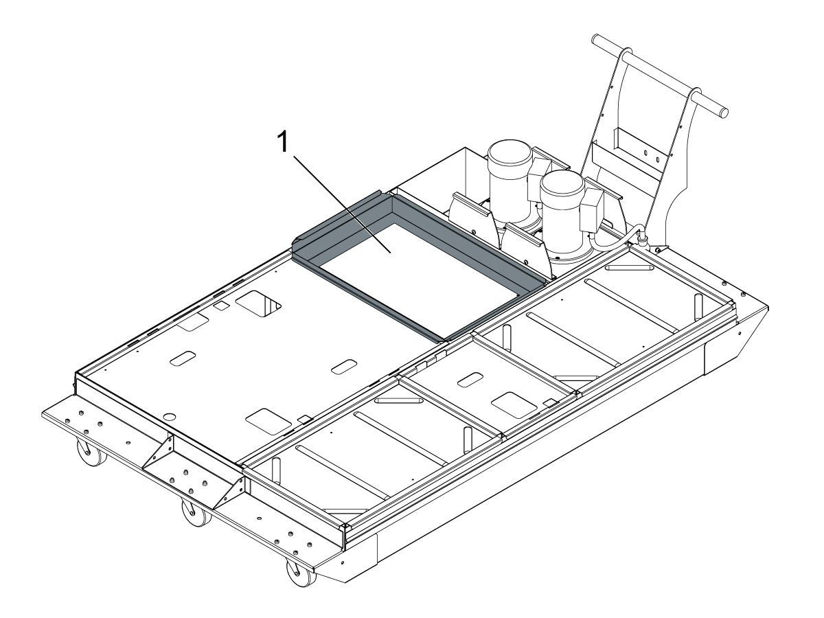

Coolant Tank
Chip tray [1] should be placed as shown in the image for 95- gallon coolant tanks.
