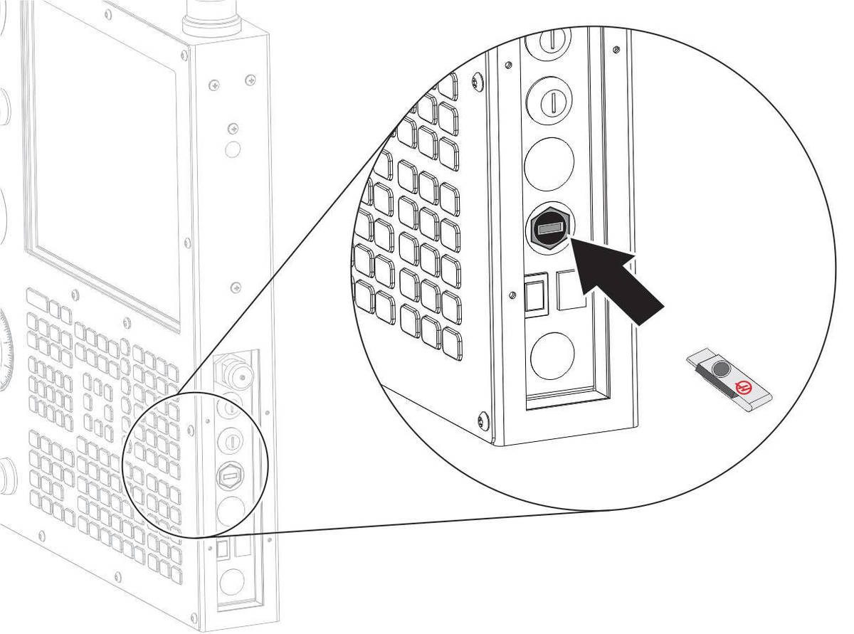

This procedure tells you how to install the backup files from a USB memory device. The USB memory device contains backup machine files, such as .VAR, .SET, .OFS, .PAR, .ATM, .IPS, .PAL, .LSC, .PGM. files.
Use a USB memory device with back up files created with Machine Data Backup (Mill16.xx and higher, and Lathe 9.xx and higher), check the back of the control cabinet for the USB memory stick or contact [email protected] to get the backup files.

Press [LIST PROG].
Navigate to the USB DEVICE tab.
