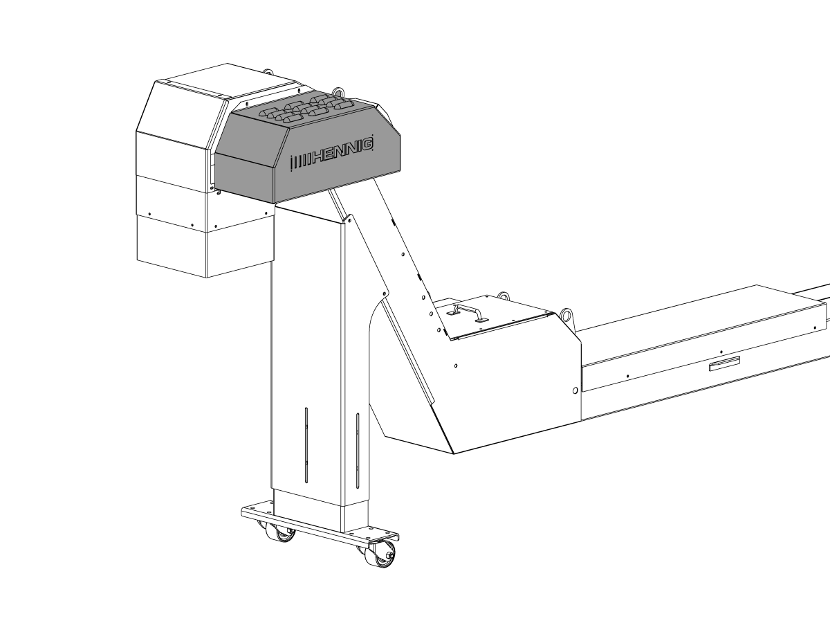

This procedure details how to install and wire a replacement motor for a CDF conveyor.
 IMPORTANT: The images in this procedure may show a normal 1/8 HP conveyor motor but the steps will be the same for the CDF conveyor motor.
This procedure will apply to the following kits:
93-3360 CHIPC MOTOR 1/4 HP 240V 50/60HZ 240:1
For Standard coveyor motor replacements refer to AD0345 - Chip Conveyor - Motor - Replacement.
Motor Replacement
Remove the sheet metal enclosure housing the motor.
Remove the cable clamps [1].
Remove the used motor.
Press the 1/4HP CHIP CONVEYOR MOTOR CDF [A] onto the conveyor shaft. Align the slot in the motor shaft with the key [2] on the conveyor shaft.
Attach the motor to the conveyor head.
Install the cable clamps [1].
Connect the electrical cable.
After completing the installation, run the conveyor by pressing [CHIP FWD] if the conveyor runs backwards please check the motor wiring and verify it is wired correctly. Use the wiring diagrams below for reference.
