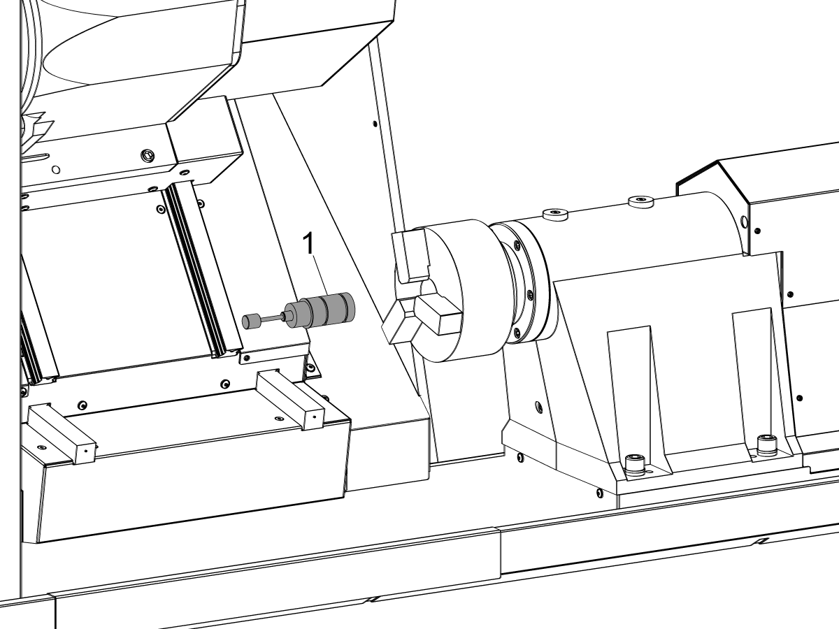

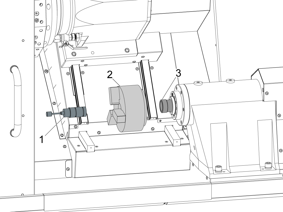

If equipped, remove the Sub-Spindle parts ejector [1] from the drawbar. See the Lathe - Sub-Spindle Part Ejector procedure.

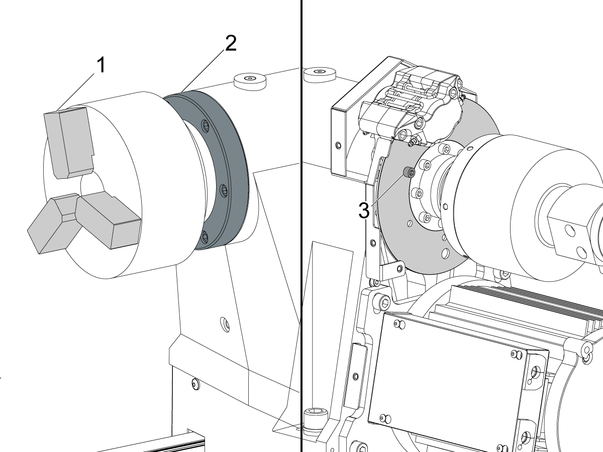

Remove the Sub-Spindle chuck [2] and chuck thread adapter [3]. It is reccomended to attempt to remove the chuck adapter using a strap wrench before resorting to other methods that might damage the threads.
Important : Sub-spindle brake may be actuated to stop the spindle from rotating. C-axis brake can be found in Current Commands > Devices > Mechanisms > Sub-spindle Brake.

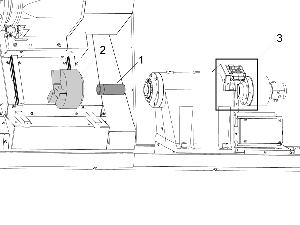

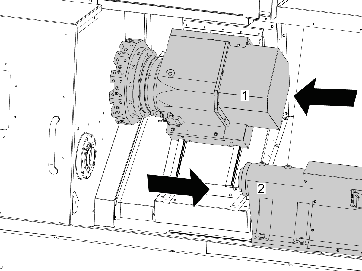

Jog the turret [1] as close to the main spindle as possible and the Sub-Spindle [2] as far from the main spindle as possible.

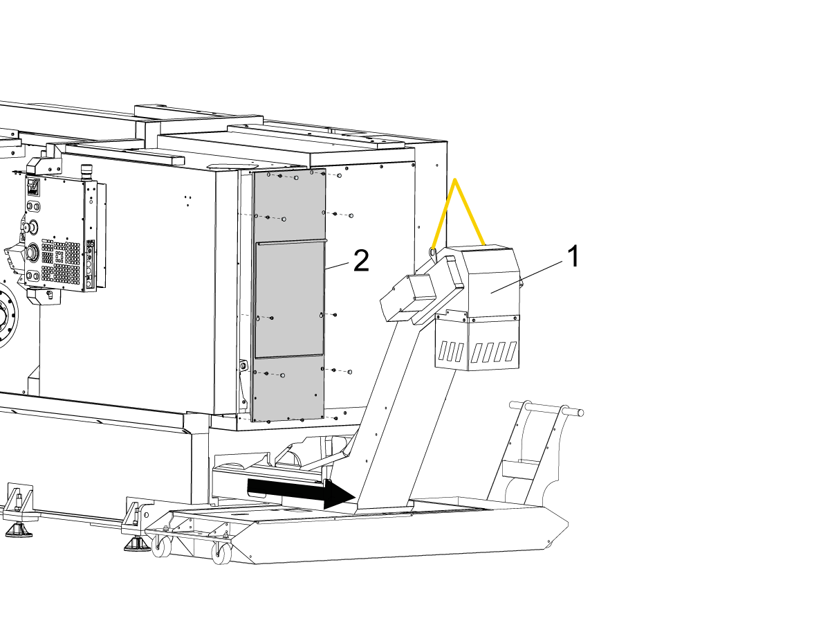

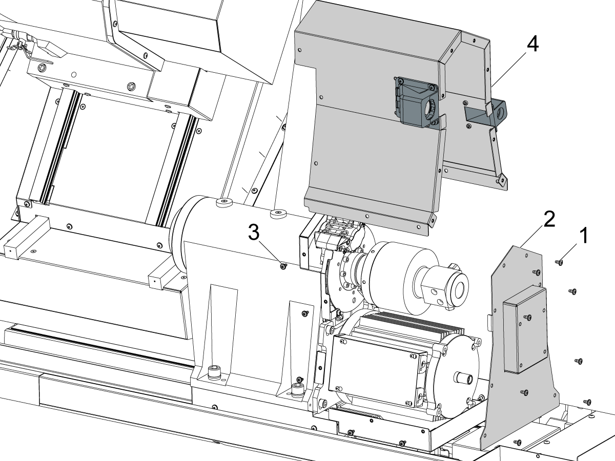

Move the conveyor [1] enough to gain access to the right enclosure panel [2].
Remove the right enclosure panel [2].
Note : The right side access panel [2] is shown in the image. Other enclosure panels may need to be removed for easier access.

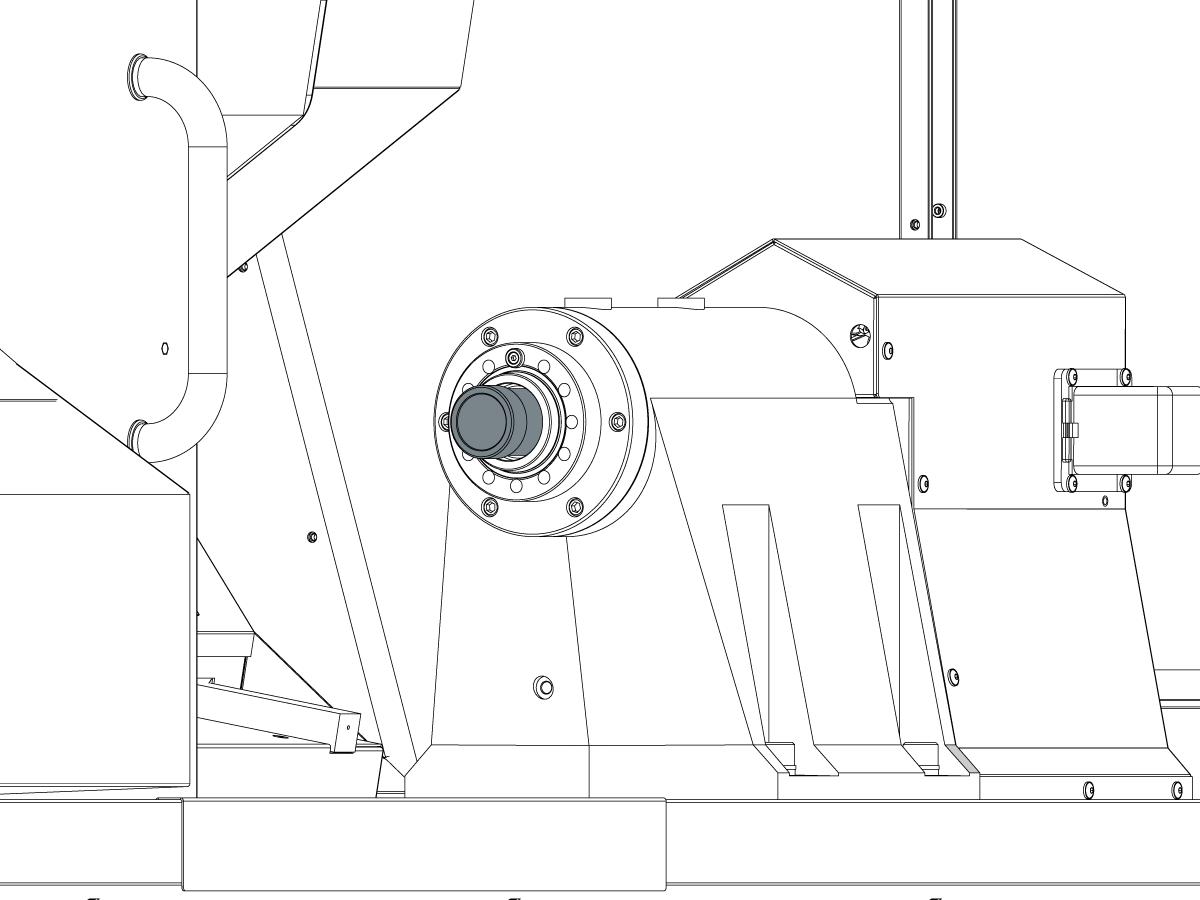

Remove Sub-Spindle covers [4] and [2] to gain access to the hydraulic union.
Note : Access is very limited which might require the cover to be removed in sections to access the hydraulic union.

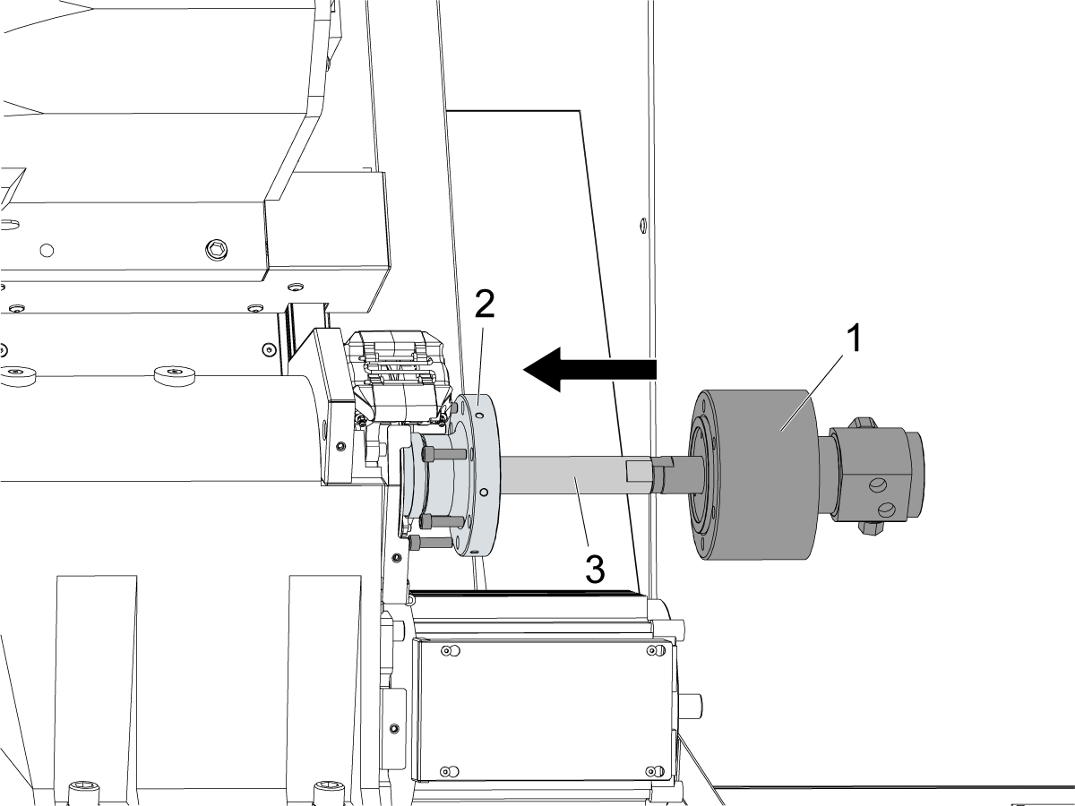

6
Remove the hydraulic union [1] from the adapter [2]. The drawbar [3] is attached to the hydraulic union.
7

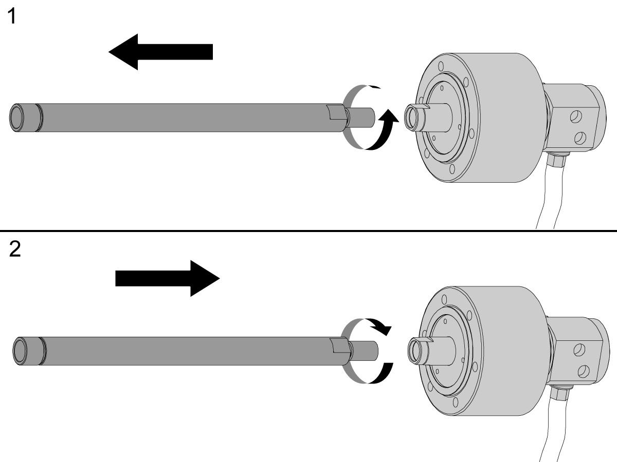

Remove [1] the drawbar from the hydraulic union by unscrewing it.
Note : It is reccomended to use an open ended wrench on the machined flats of the drawbar to unscrew it.

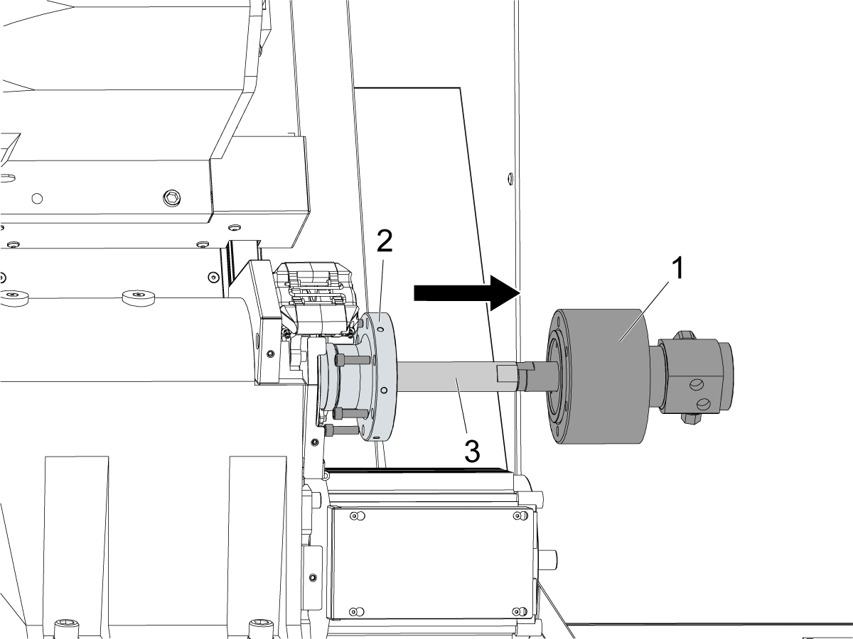

Install the hydraulic union [1] with drawbar [3] into the back of the Sub-Spindle and attach it to the adapter [2]. Torque bolt per HAAS TORQUE CHART in a star pattern. C-axis brake may be used to stop spindle rotation.
Important : Make sure that the hydraulic union runout does not exceed 0.0005" TIR.

Install the chuck adapter [1] by using the foot pedal in MDI mode to extend the sub-spindle draw bar the pressing [E-STOP] and applying thread lock all the way around the first 2 threads of the chuck adapter. Thread the chuck adapter onto the sub-spindle draw tube until the threads bottom out by hand. Apply CHUCK EEZ grease or any similar chuck grease to the outer threads of the chuck adapter before installing the chuck.
If equipped, install the Sub-Spindle parts ejector [1]. See the Lathe - Sub-Spindle Part Ejector procedure.

Install Sub-Spindle covers  [4] and [2] using hardware [3] and [1].

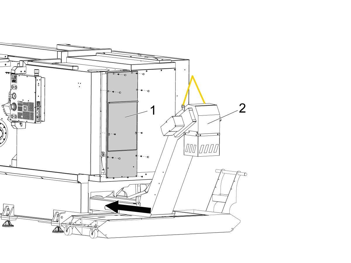

Install the right enclosure panel [1] along with any other panels that were removed.
Move the conveyor [2] back into position.
