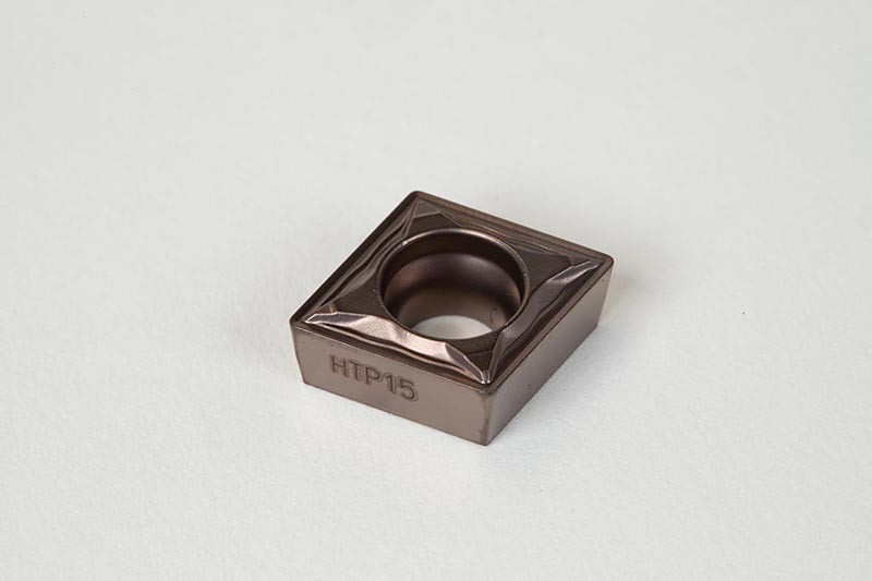

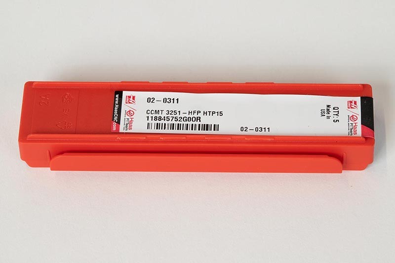

CCMT3251-HFP/CCMT09T304-HFP, inserto de torneado de carburo, rombo 80°, grado HTP15 - paquete de 5
N.º ref.: 02-0311
CCMT 3251-HFP HTP15

Estilo de plaquitaThe shape of the insert: round, square, diamond, octagonal, etc. The shape of the insert defines the point angle, which determines the strength of the cutting edge, the ability to cut fine features, and the number of indexable cutting edges available. Estilo C - Rombo 80°
Material de pieza principal P - Acero
Material de pieza secundario K - Hierro fundido
GradoThe type of coating on the insert, which determines the toughness and wear resistance of the insert, as well as the types of material for which the insert can be used. HTP15 - Interrupción ligera
Material Carburo
Rompevirutas HFP - Acabado positivo
[IC] Diámetro de círculo inscrito 0,375 pulgadas \ 9,53 mm
[D1] Tamaño de orificio de plaquita 0,173 pulgadas/4,4 mm
[L10] Longitud del filo de corte 0,381 pulgadas \ 9,67 mm
[S] Grosor de la plaquita 0,156 pulgadas \ 3,97 mm
[RE] Radio de esquinas 0,0157 pulgadas \ 0,4 mm
Peso 0,1 lb/0,1 kg
País de origen India
