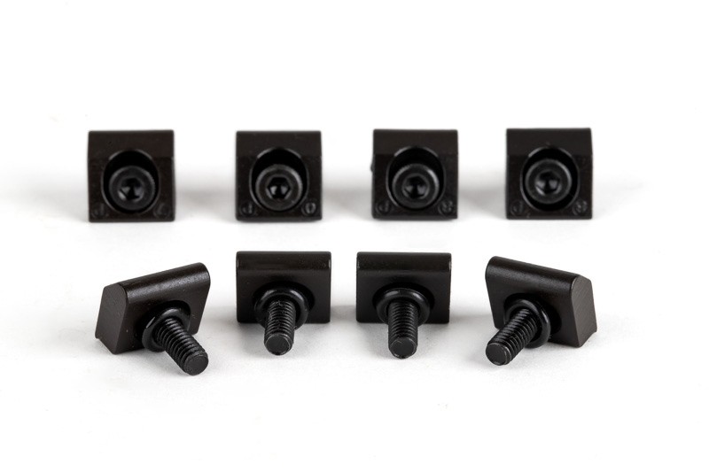

Abrazadera Pitbull de borde de cuchilla M4x0,7, de Mitee-Bite - Paquete de 8
N.º ref.: 05-0425
PITBULL CLAMPS M4 TS KE-8PK
Precio: 80.95 ( / unidad)
  • Documentación técnica
Clamp Series Pitbull Clamp
Edge Type Knife Edge
Material Tool Steel
[W] Width 12.7 mm
[A] Dimension 5.08 mm
[B] Dimension 4.75 mm
[C] Dimension 12.7 mm
[D] Dimension 2.54 mm
[E] Dimension 9.9 mm
[TP1] Thread M4x0.7
Maximum Torque 5.6 N-m
Holding Force 6600 N
Total Throw 0.41 mm
Country of Origin USA
