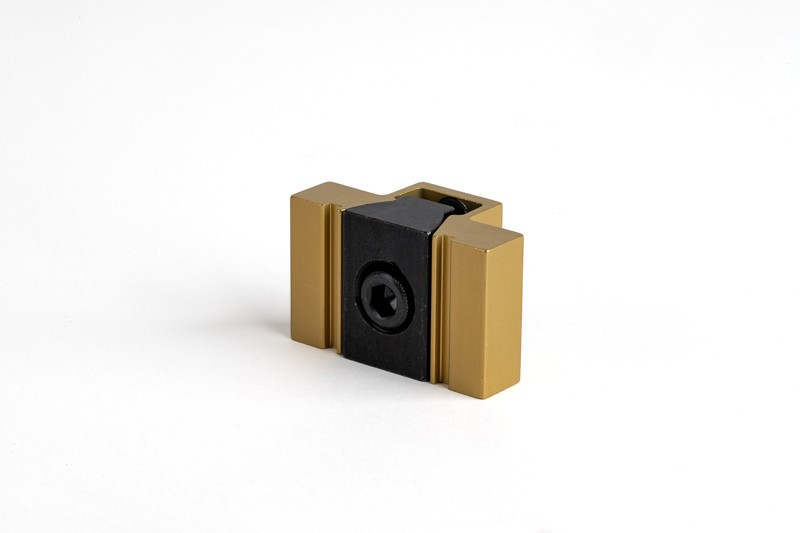

Abrazadera Uniforce mecanizable de 3/4”, de Mitee-Bite
N.º ref.: 05-0435
MACHINABLE UNIFORCE CLAMP 750
Precio: 17.95 ( / unidad)
  • Documentación técnica
Clamp Series Uniforce Clamp
Edge Type Machinable Edge
Material Tool Steel, Aluminum
[A] Dimension 1.5 in
[B] Dimension 0.75 in
[C] Dimension 0.94 in
[D] Dimension 0.632 in
[E] Dimension 0.37 in
[F] Dimension 0.26 in
[G] Dimension 0.625 in
[TP2] Thread #6-32
[TP1] Thread 1/4"-20
Maximum Torque 10.0 ft-lb
Holding Force 1500 lbs
Country of Origin USA
