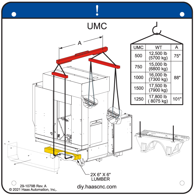

Lifting Instructions
Read these instructions in their entirety before attempting to lift the machine.
WARNING:
IT IS IMPERATIVE THAT PREPARATION AND LIFTING OF THE MACHINE BE PERFORMED BY PROFESSIONAL RIGGERS. THESE INSTRUCTIONS ARE FOR REFERENCE PURPOSES ONLY.
IMPORTANT: Most – but not all* – Haas machines may be lifted by overhead crane for positioning and installation. Depending on the model, your new Haas machine may have built-in lifting provisions, or may require a lifting kit, available through your local Haas Factory Outlet (HFO), that includes required lifting brackets and hardware.
Refer to the lifting placard on the rear of the machine to locate all critical lifting points.
Specialized equipment is necessary to ensure that the machine is secure and level during lifting. When lifting the machine, slowly lift until all chains are taut, then lift the machine, making sure it stays balanced. Remove lifting brackets and hardware, if installed, before machine operation, unless otherwise noted. It is the customer’s responsibility to supply all chains and spreader bars required to properly lift the machine. Contact your local HFO for more information. Retain any supplied lifting brackets and hardware, and store them in a safe place for future use. Use only Haas-supplied lifting hardware, if required.
Refer to the lifting placard on the rear of the machine for model-specific lifting information. Attach the lifting bracket, if required, and chains as shown. Make sure that the chains do not contact the sheet metal enclosure or electrical cables. Note the use of spreader bars and lumber. Haas Automation, Inc., does not provide spreader bars or lumber.
*GR, GM, TL, CM, and CL models are not suitable for overhead lifting. They must be lifted by forklift.
