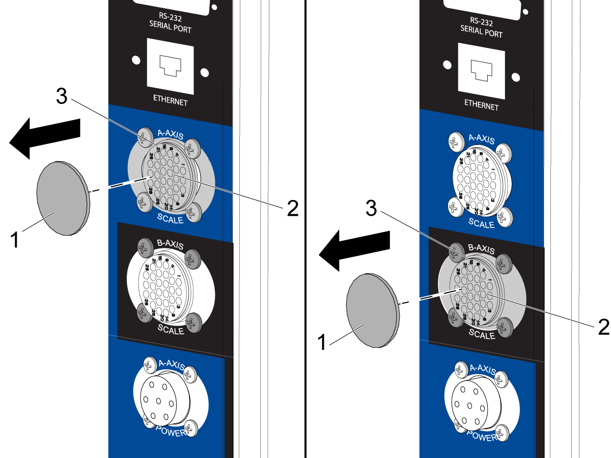

Find the plug [1] for the 4th-AXIS SCALE / A-AXIS SCALE or 5th-AXIS SCALE / B-AXIS SCALE receptacle. The plug is on the side of the control cabinet. Pull the plug out of the hole.
Connect the 28-pin connector [2] from the rotary scale feedback cable to the receptacle. Use the (4) 4-40 screws [3].

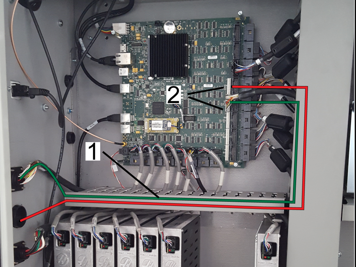

Remove the center cable track cover and the track cover below the MainCon PCB.
Remove the MainCon PCB cover.
Route the 4th-AXIS SCALE / A-AXIS SCALE or 5th-AXIS SCALE / B-AXIS SCALE cable [1] as shown.
Connect the 11-pin connector of the rotary scale feedback cable to the correct connector on the MainCon PCB:
  • 4th-AXIS SCALE / A-AXIS SCALE Scales Channel 12A (P36)
  • 5th-AXIS SCALE / B-AXIS SCALE Scales Channel 13A (P37)
Install the covers.

Find the (2) plugs [1] for the 4th-Axis / A-Axis receptacles. The plugs are on the side of the control cabinet. Push the plugs out of the holes.
Install the 7-pin power connector [2] into the receptacle that has the label 4th-AXIS POWER / A-AXIS POWER. Use the (4) screws.
Install the 28-pin encoder connector [3] in the receptacle that has the label 4th-AXIS ENCODER / A-AXIS POWER. Use the (4) screws.

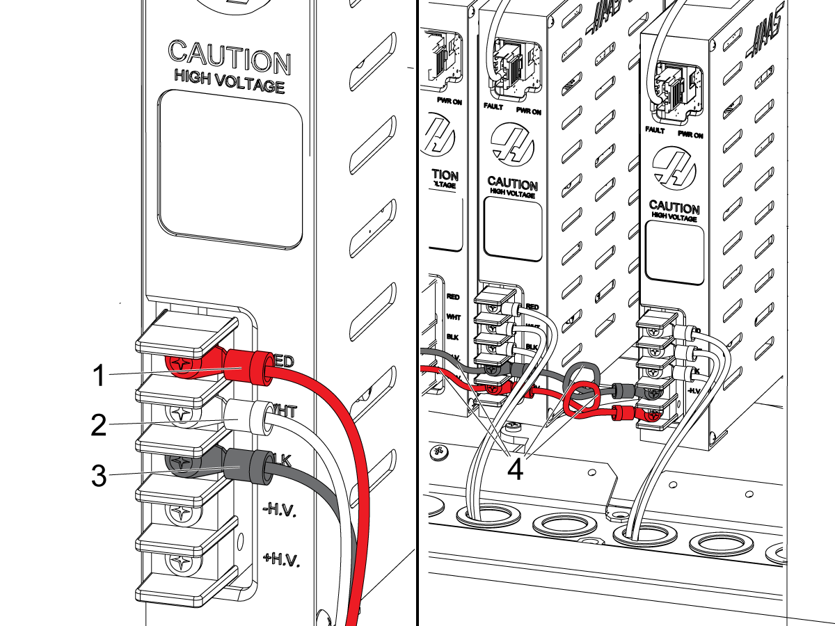

Connect the fourth-axis servo cable wires to the high-voltage terminals on the amplifier:
  • red to RED [1]
  • white to WHT [2]
  • black to BLK [3]
Connect jumpers [4] from the fourth-axis drive to the nearest amplifier on each side:
  • Connect the black wire to -H.V..
  • Connect the red wire to +H.V..
 Caution: On older machines the fourth-axis servo cable may have a shielded wire attached to the black jumper. Connect the shielded wire to -H.V. Do not connect it to the machine ground.

Connect the 3-pin connector [1] on the A-Axis brake cable to P16 [2] on the I/O PCB.
Connect the 16-pin connector [4] on the encoder cable to Encoder Channel 4 (P20) [3] on the Main Control PCB.
Connect the 8-pin connector [5] on the current-command cable to the Amplifier Channel 4 (P4) socket [6] of the Main Control PCB.
Connect the 8-pin connector [7] on the current-command cable to the ampifier [8].

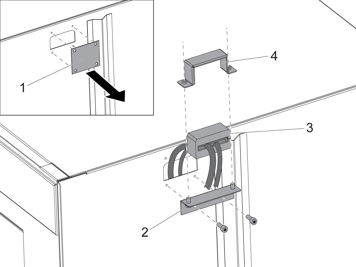

Remove the blanking plate [1].
Install the clamp block mount [2].
Put the rotary cables through the clamp block [3].
Install the clamp block retainer [4].
If you are not installing a fifth-axis drive, install the cover plates for the Maincon PCB and I/O PCB.

Connect the fifth-axis servo cable wires to the high-voltage terminals on the amplifier:
  • red to RED [1]
  • white to WHT [2]
  • black to BLK [3]
Connect jumpers [4] from the fifth-axis drive to the nearest amplifier on each side:
 Caution: On older machines the fifth-axis servo cable may have a shielded wire attached to the black jumper. Connect the shielded wire to -H.V. Do not connect it to the machine ground.
Install the cover plates for the Maincon PCB and I/O PCB.
