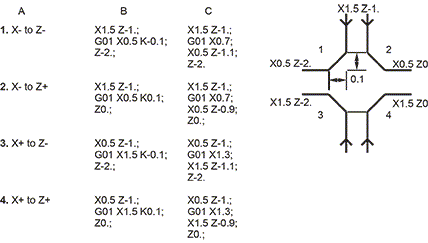

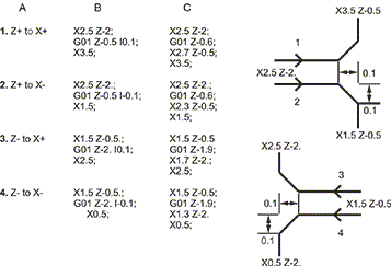

This G-code syntax automatically includes a 45 chamfer or corner radius between two blocks of linear interpolation which intersect a right (90 degree) angle.
Chamfering Syntax
G01 X(U) x Kk ;
G01 Z(W) z Ii ;

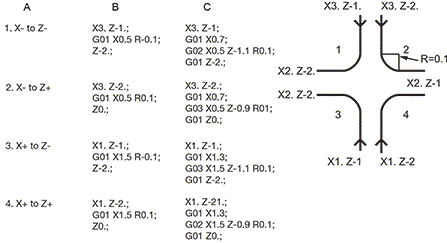

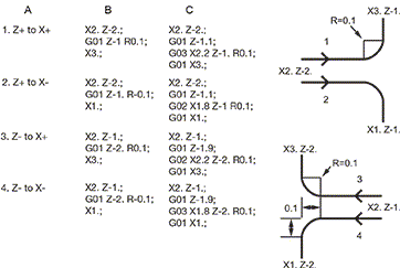

Corner Rounding Syntax
G01 X(U) x Rr ;
G01 Z(W) z Rr ;
Addresses:
I = chamfering, Z to X
K = chamfering, X to Z
R = corner rounding (X or Z axis direction)
Notes:
  1. Incremental programming is possible if U or W is specified in place of X or Z, respectively. So its actions are as follows:

Chamfering Code Z to X: [A] Chamfering, [B] Code/Example, [C] Movement.
Chamfering Code X to Z: [A] Chamfering, [B] Code/Example, [C] Movement.
Corner Rounding Code Z to X: [A] Corner rounding, [B] Code/Example, [C] Movement.
Corner Rounding Code X to Z: [A] Corner rounding, [B] Code/Example, [C] Movement.
Rules:
  1. Use K address only with X(U)address. Use I address only with Z(W) address.
  2. Use R address with either X(U) or Z(W), but not both in the same block.
  3. Do not use I and K together on the same block. When using R address, do not use I or K.
  4. The next block must be another single linear move that is perpendicular to the previous one.
  5. Automatic chamfering or corner rounding cannot be used in a threading cycle or in a Canned cycle.
  6. Chamfer or corner radius must be small enough to fit between the intersecting lines.
  7. Use only a single X or Z-axis move in linear mode (G01) for chamfering or corner rounding.
