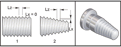

NOTE
Feedrate is equivalent to thread lead. Movement on at least one axis must be specified. Tapered threads have lead in both X and Z. In this case set the feedrate to the larger of the two leads. G99 (Feed per Revolution) must be active.
G32 Definition of Lead (Feedrate): [1] Straight thread, [2] Tapered thread.

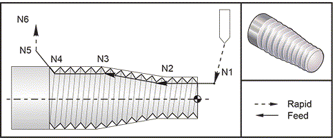

Straight-to-Taper-to-Straight Thread Cutting Cycle
NOTE
Example is for reference only. Multiple passes are usually required to cut actual threads.
o60321 (G32 THREAD CUTTING WITH TAPER) ;
(G54 X0 is at the center of rotation) ;
(Z0 is on the face of the part) ;
(T1 is an OD thread tool) ;
(BEGIN PREPARATION BLOCKS) ;
T101 (Select tool and offset 1) ;
G00 G18 G20 G40 G80 G99 (Safe startup) ;
G50 S1000 (Limit spindle to 1000 RPM) ;
G97 S500 M03 (CSS off, Spindle on CW) ;
N1 G00 G54 X0.25 Z0.1 (Rapid to 1st position) ;
M08 (coolant on) ;
(BEGIN CUTTING BLOCKS) ;
N2 G32 Z-0.26 F0.065 (Straight thread, Lead = .065) ;
N3 X0.455 Z-0.585 (Blend to tapered thread) ;
N4 Z-0.9425 (Blend back to straight thread) ;
N5 X0.655 Z-1.0425 (Pull off at 45 degrees) ;
(BEGIN COMPLETION BLOCKS) ;
N6 G00 X1.2 M09 (Rapid Retract, Coolant off) ;
G53 X0 (X home) ;
G53 Z0 M05 (Z home, spindle off) ;
M30 (End program) ;
