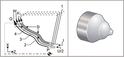

G73 Irregular Path Stock Removal Cycle (Group 00)
D - Number of cutting passes, positive integer
 F - Feedrate in inches (mm) per minute ( G98) or per revolution ( G99) to use throughout G73 PQ block
I - X-axis distance and direction from first cut to last, radius
K - Z-axis distance and direction from first cut to last
P - Starting Block number of path to rough
Q - Ending Block number of path to rough
* S - Spindle speed to use throughout G73 PQ block
* T - Tool and offset to use throughout G73 PQ block
* U - X-axis size and direction of G73 finish allowance, diameter
* W - Z-axis size and direction of G73 finish allowance
* indicates optional
G18 Z-X plane must be active
NOTE
The P values are modal. This means if you are in the middle of a canned cycle and a G04 Pnn or an M97 Pnn is used the P value will be used for the dwell / subprogram as well as the canned cycle.
G73 Irregular Path Stock Removal: [P] Starting block, [Q] Ending block [1] Start position, [2] Programmed path, [3] Finish allowance, [4] Roughing allowance.
The G73 canned cycle can be used for rough cutting of preformed material such as castings. The canned cycle assumes that material has been relieved or is missing a certain known distance from the programmed tool path PQ.
Machining starts from the current position (S), and either rapids or feeds to the first rough cut. The nature of the approach move is based on whether a G00 or G01 is programmed in block P. Machining continues parallel to the programmed tool path. When block Q is reached a rapid departure move is executed to the Start position plus the offset for the second roughing pass. Roughing passes continue in this manner for the number of rough passes specified in D. After the last rough is completed, the tool returns to the starting position S.
Only F, S and T prior to or in the G73 block are in effect. Any feed (F), spindle speed (S) or tool change (T) codes on the lines from P to Q are ignored.
The offset of the first rough cut is determined by (U/2 + I) for the X Axis, and by (W + K) for the Z Axis. Each successive roughing pass moves incrementally closer to the final roughing finish pass by an amount of (I/(D- 1)) in the X Axis, and by an amount of (K/(D-1)) in the Z Axis. The last rough cut always leaves finish material allowance specified by U/2 for the X Axis and W for the Z Axis. This canned cycle is intended for use with the G70 finishing canned cycle.
The programmed tool path PQ does not have to be monotonic in X or Z, but care has to be taken to insure that existing material does not interfere with tool movement during approach and departure moves.
NOTE
Monotonic curves are curves that tend to move in only one direction as x increases. A monotonic increasing curve always increases as x increases, i.e. f(a)>f(b) for all a>b. A monotonic decreasing curve always decreases as x increases, i.e. f(a)<f(b) for all a>b. The same sort of restrictions are also made for the monotonic non-decreasing and monotonic non-increasing curves.
The value of D must be a positive integral number. If the D value includes a decimal, an alarm is generated. The four quadrants of the ZX plane can be machined if the following signs for U, I, W, and K are used.
