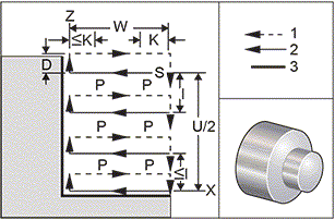

* D - Tool clearance when returning to starting plane, positive radius
* F - Feed rate
* I - X-axis size of increment between peck cycles, positive diameter
K - Z-axis size of increment between pecks in a cycle
* U - X-axis incremental distance away from current X position before returning to the start plane.
W - Z-axis incremental distance to total pecking depth
X - X-axis absolute location of furthest peck cycle (diameter)
Z - Z-axis absolute location total pecking depth
*indicates optional
G74 End Face Grooving Cycle Peck Drilling: [1] Rapid, [2] Feed, [3] Programmed Path, [S] Start position, [P] Peck retraction (Setting 22).
The G74 canned cycle is used for grooving on the face of a part, peck drilling, or turning.
***Warning: The D code command is rarely used and should only be used if the wall on the outside of the groove does not exist like the figure above. The D code can be used in grooving and turning to provide a tool clearance shift, in the X axis, before returning in the Z axis to the  C clearance point. But, if both sides to the groove exist during the shift, then the groove tool would break. So you wouldn t want to use the D command.
A minimum of two pecking cycles occur, if an X, or U, code is added to a G74 block and X is not the current position. One at the current location and then at the X location. The I code is the incremental distance between X-Axis pecking cycles. Adding an I performs multiple pecking cycles between the starting position S and X. If the distance between S and X is not evenly divisible by I then the last interval is less than I.
When K is added to a G74 block, pecking is performed at each interval specified by K, the peck is a rapid move opposite the direction of feed with a distance defined by Setting 22. The D code can be used for grooving and turning to provide material clearance when returning to starting plane S.

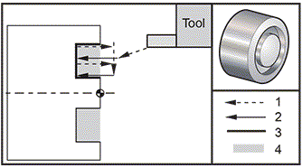

G74 End Face Grooving Cycle: [1] Rapid, [2] Feed, [3] Groove.
O60741 (G74 END FACE) ;
(G54 X0 is at the center of rotation) ;
(Z0 is on the face of the part) ;
(T1 is an end face cutting tool) ;
(BEGIN PREPARATION BLOCKS) ;
T101 (Select tool and offset 1) ;
G00 G18 G20 G40 G80 G99 (Safe startup) ;
G50 S1000 (Limit spindle to 1000 RPM) ;
G97 S500 M03 (CSS off, Spindle on CW) ;
G00 G54 X3. Z0.1 (Rapid to 1st position) ;
M08 (Coolant on) ;
G96 S200 (CSS on) ;
(BEGIN CUTTING BLOCKS) ;
G74 Z-0.5 K0.1 F0.01 (Begin G74) ;
(BEGIN COMPLETION BLOCKS) ;
G97 S500 (CSS off) ;
G00 G53 X0 M09 (X home, coolant off) ;
G53 Z0 M05 (Z home, spindle off) ;
M30 (End program) ;
