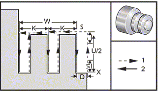

Service Home G75 O.D./I.D. Grooving Cycle (Group 00)
*D - Tool clearance when returning to starting plane, positive
*F - Feed rate
*I - X-axis size of increment between pecks in a cycle (radius measure)
*K - Z-axis size of increment between peck cycles
*U - X-axis incremental distance to total pecking depth
W - Z-axis incremental distance to furthest peck cycle
X - X-axis absolute location total pecking depth (diameter)
Z - Z-axis absolute location to furthest peck cycle
* indicates optionalG75 O.D./I.D. Grooving Cycle: [1] Rapid, [2] Feed, [S] Start position.
The G75 canned cycle can be used for grooving an outside diameter. When a Z, or W, code is added to a G75 block and Z is not the current position, then a minimum of two pecking cycles occur. One at the current location and another at the Z location. The K code is the incremental distance between Z axis pecking cycles. Adding a K performs multiple, evenly spaced, grooves. If the distance between the starting position and the total depth (Z) is not evenly divisible by K then the last interval along Z is less than K.
NOTE: Chip clearance is defined by Setting 22.

The following program is an example of a G75 program (Multiple Pass):G75 O.D. Multiple Pass: [1] Tool, [2] Rapid, [3] Feed, [4] Groove.
