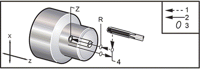

Service Home G84 Tapping Canned Cycle (Group 09)
F - Feed Rate
* R - Position of the R plane
S - RPM, called prior to G84
* X - X-axis motion command
* Q - Peck Depth (always incremental)
Z - Position of bottom of hole
* indicates optionalProgramming Notes:It is not necessary to start the spindle CW before this canned cycle. The control does this automatically.
When G84 tapping on a lathe, it is simplest to use G99 Feed Per Revolution.
The Lead is the distance traveled along a screw's axis, with each full revolution.
The feedrate, when using G99, is equal to the Lead of the tap.
An S value must be called prior to the G84. The S value determines the RPM of the tapping cycle.
In Metric Mode ( G99, with Setting 9 = MM), the feedrate is the metric equivalent of the lead, in MM.
In Inch Mode ( G99, with Setting 9 = INCH), the feedrate is the Inch equivalent of the lead, in inches.
The lead (and G99 feedrate) of an M10 x 1.0mm tap is 1.0mm, or .03937" (1.0/25.4=.03937).
Examples:1. The lead of a 5/16-18 tap is 1.411 mm (1/18*25.4 = 1.411), or .0556" (1/18 = .0556)
2. This canned cycle can be used on the secondary spindle of a Dual Spindle DS lathe, when prefaced by a G14.Refer to the G14 Secondary Spindle Swap for more information.
3. For Axial Live-Tool tapping, use a G95 or G186 command.
4. For Radial Live-Tool tapping, use a G195 or G196 command.
5. For Reverse Tapping (left-hand thread) on the Main or Secondary Spindle,refer to G184 Reverse Tapping Canned Cycle For Left Hand Threads (Gr... .
More programming examples, in both Inch and Metric, are shown below:G84 Tapping Canned Cycle: [1] Rapid, [2] Feed, [3] Start or end of stroke, [4] Starting plane, [R] R plane, [Z] Position at the bottom of the hole.
