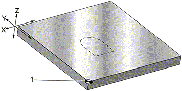

These examples illustrate rotation with G68. The first program defines a Gothic window shape to cut. The rest of the programs use this program as a subprogram.
G68 Start Gothic Window, No rotation: [1] Work coordinate origin.
O60681 (GOTHIC WINDOW SUBPROGRAM) ;
F50. S15000 (SET FEED AND SPINDLE SPEED) ;
G00 X1. Y1. Z0.1(RAPID TO LOWER-LEFT WINDOW CORNER) ;
Z-.005;
G01 X2. (BOTTOM OF WINDOW) ;
Y2. (RIGHT SIDE OF WINDOW);
G03 X1. R0.5 (TOP OF WINDOW) ;
G01 Y1. (FINISH WINDOW) ;
Z0.1 (RETRACT Z BEFORE GOING TO THE NEXT WINDOW);
M99;

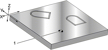

The next example specifies the center of the window as the rotation center.
G68 Rotation Center of Window: [1] Work coordinate origin, [2] Center of rotation.
O60683 (ROTATE ABOUT CENTER OF WINDOW) ;
G59 (OFFSET) ;
G00 G90 X0 Y0 Z0.1 (WORK COORDINATE ORIGIN) ;
G68 X1.5 Y1.5 R60. ;
(ROTATE SHAPE 60 DEGREES ABOUT CENTER) ;
M98 P60681 (CALL SUBPROGRAM) ;
G69 G90 G00 X0 Y0 (CANCEL G68, LAST COMMANDED POSITION) ;
M30 ;

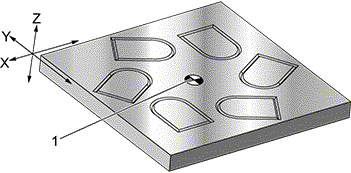

This next example shows how the G91 mode can be used to rotate patterns about a center. This is often useful for making parts that are symmetric about a given point.
G68 Rotate Patterns About Center: [1] Work coordinate origin and center of rotation.
O60684 (ROTATE PATTERN ABOUT CENTER) ;
G59 (OFFSET) ;
M97 P1000 L6 (CALL LOCAL SUBPROGRAM, LOOP 6 TIMES) ;
M30 (END AFTER SUBPROGRAM LOOP) ;
N1000 (BEGIN LOCAL SUBPROGRAM) ;
G91 G68 R60. (ROTATE 60 DEGREES) ;
G90 M98 P60681 (CALL WINDOW SUBPROGRAM) ;
G90 G00 X0 Y0 (LAST COMMANDED POSITION) ;
M99;
