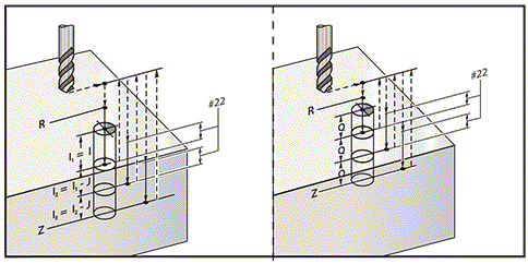

G83 Normal Peck Drilling Canned Cycle (Group 09)
* E - Chip-clean RPM (Spindle reverses to remove chips after each cycle)
F - Feedrate
* I - Size of first peck depth
* J - Amount to reduce peck depth each pass
* K - Minimum depth of peck
* L - Number of holes if G91 (Incremental Mode) is used, also G81 through G89.
* P - Pause at end of last peck, in seconds (Dwell)
* Q - Peck depth, always incremental
* R - Position of the R plane (position above the part)
* X - X-Axis location of hole
* Y - Y-Axis location of hole
Z - Position of the Z-Axis at the bottom of hole
* indicates optional
If I, J, and K are specified, the first pass will cut in by the amount of I, each succeeding cut will be reduced by amount J, and the minimum cutting depth is K. Do not use a Q value when programming with I, J, and K.
If P is specified, the tool will pause at the bottom of the hole for that amount of time. The following example will peck several times and dwell for 1.5 seconds:
G83 Z-0.62 F15. R0.1 Q0.175 P1.5 ;
The same dwell time will apply to all subsequent blocks that do not specify a dwell time.
G83 Peck Drilling with I, J, K and Normal Peck Drilling: [#22] Setting 22.
Setting 52 changes the way G83 works when it returns to the R plane. Usually the R plane is set well above the cut to ensure that the peck motion allows the chips to get out of the hole. This wastes time as the drill starts by drilling empty space. If Setting 52 is set to the distance required to clear chips, you can set the R plane much closer to the part. When the chip-clearing move to R occurs, Setting 52 determines the Z-Axis distance above R.
G83 peck Drilling Canned Cycle with Setting 52 [#52]
