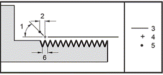

This setting is used in G76 and G92 threading cycles when an M23 is commanded. When command M23 is active, threading strokes end with an angled retraction, as opposed to pulling straight out. The value in Setting 95 is equal to the number of turns (chamfered threads) desired.
NOTE
Settings 95 and 96 interact with each other. (Multiple of current thread lead, F or E ).
Setting 95 - Thread Chamfer Size, G76 or G92 threading stroke with M23 active: [1] Setting 96 = 45, [2] Setting 95 x Lead, [3] Tool path, [4] Calculated Chamfer start point based on values in settings 95 and 96, [5] Programmed thread endpoint, [6] Lead.
