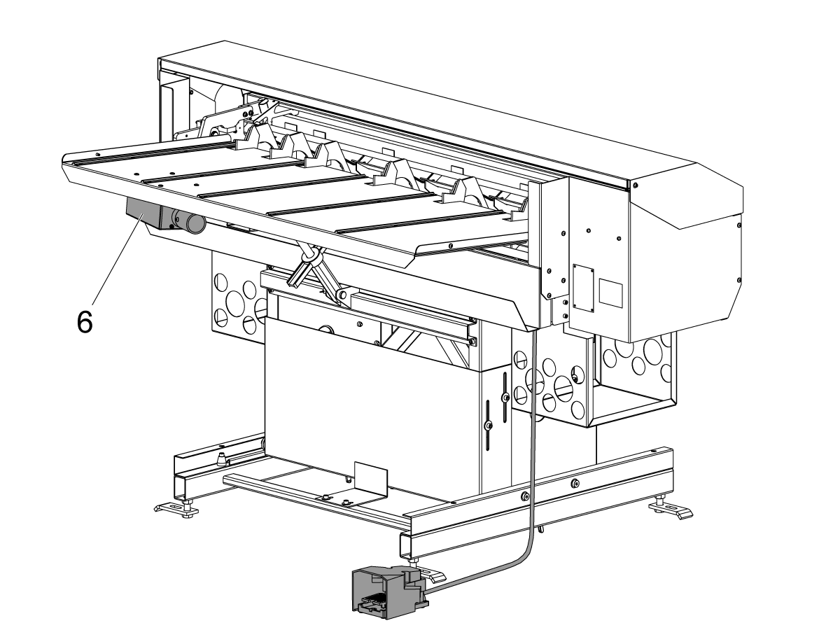

Features
The Haas Bar Feeder has a heavy-duty, compact design, with capacity for bars from 3/8" (10 mm) to 3 1/8" (79 mm) in diameter. Refer to the Haas web site at www.HaasCNC.com for more dimensions and information.
Before you use your Haas Bar Feeder, take some time to become familiar with some of the features that are different from previous-generation Haas Bar Feeders. Refer to the Operation chapter of this manual for more information on how these features work.
1. High-Speed, Belt-Driven Bar Pusher: This mechanism quickly, smoothly, and accurately feeds bar stock into your lathe.
2. Quick-Change Push Rod: Lets you change push rods quickly and easily, without tools and no need for alignment.
3. Front-Mounted Transfer Tray Height-Adjustment Wheel: Lets you adjust the transfer tray height on the lathe-spindle end of the Bar Feeder, for faster and easier setup.
4. Setup Mode Release Pedal: Use this pedal to release the Bar Feeder and slide it back into Lathe Set Up mode.
5. Extruded Spindle Liner Storage Racks: Store your spindle liners here for easy access.
6. Bar Feeder Chamfering Machine: This mechanism allows you to add a chamfer on to round bar stock before placing them into your Bar Feeder.
