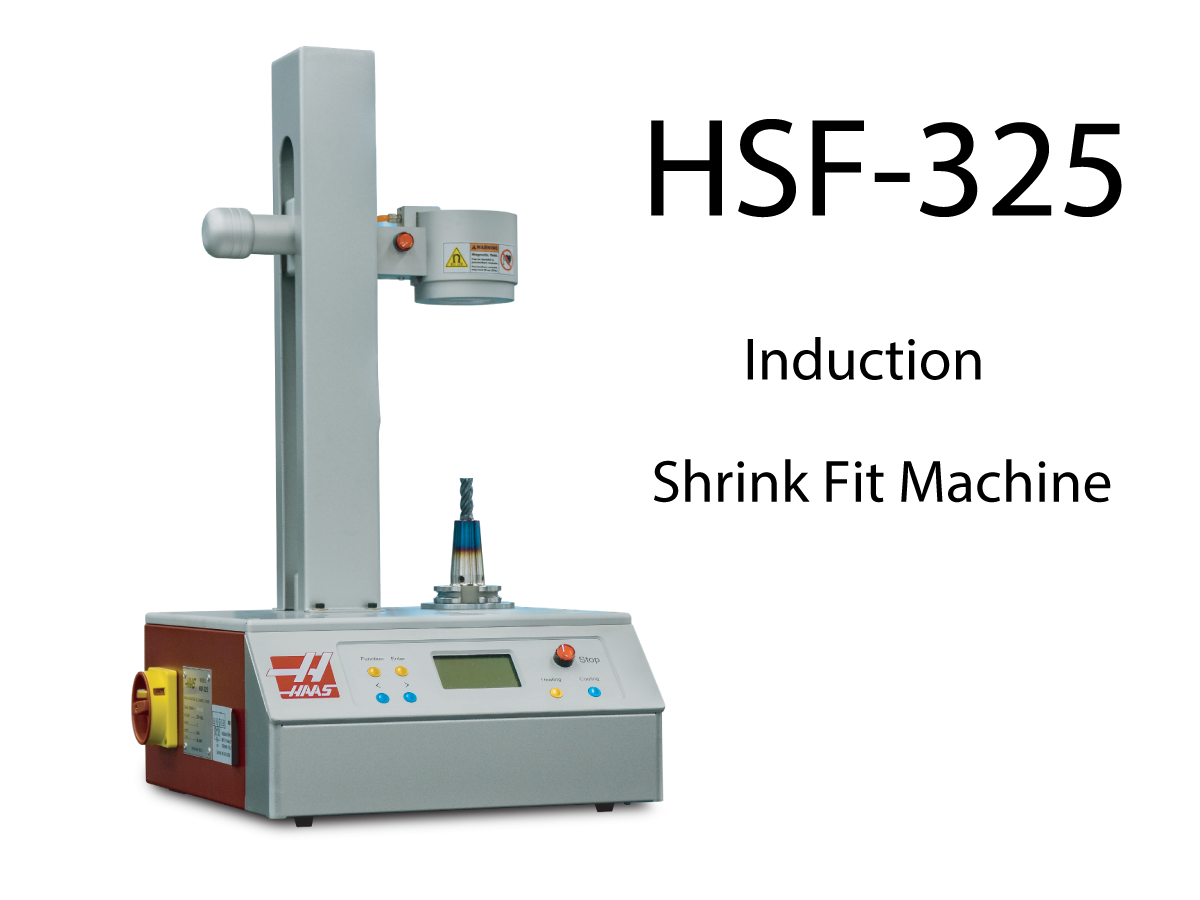

1.1 Introduction
Overview
This manual supplement describes the features and functions of the HSF-325.
Disclaimer
Only a certified technician is allowed to repair this machine.

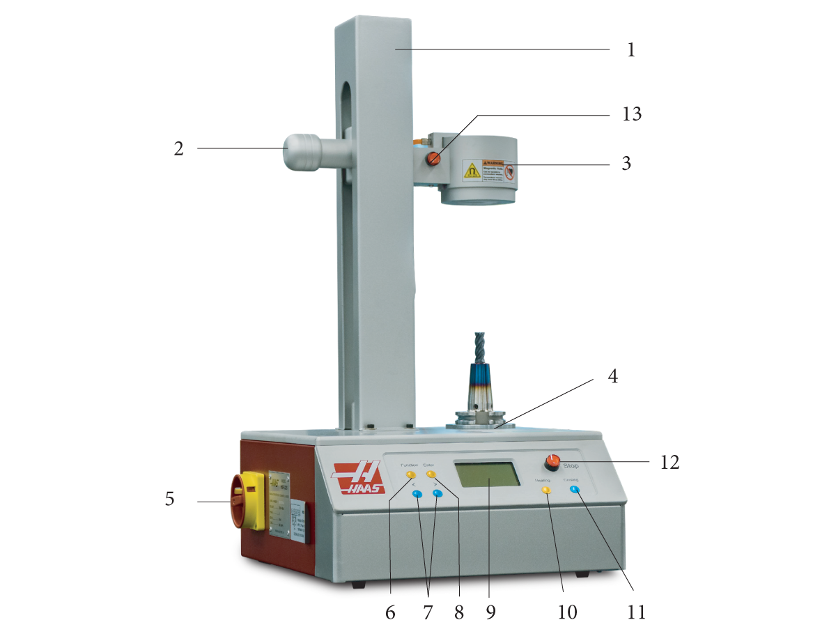

1.2 Specifications
Name and Illustrations of All Parts
  1. Up/Down Guide Rail and Cover
  2. Locking Knob
  3. Induction Heating Head
  4. Tool Sleeve
  5. Main Power On/Off Switch
  6. Function Key
  7. Left/Right Arrow Keys
  8. Enter Key
  9. LCD Display
  10. Heating Key (Start)
  11. Cooling Key (Cooling)
  12. Stop Button (Stop)
  13. Manual Heating Button
Machine Specifications
Specifications for the 220V version:
  1. Power Supply: 220V AC 60 HZ, 3 phase + ground terminal
  2. Max. consumption power: 10,000 Watts
  3. Dimensions (W x D x H): 15" x 16" x 25.75" (380 x 405 x 655 mm)
  4. Max air pressure: 100 PSI.
Specifications for the 400V version:
  1. Power Supply: 400V AC 60 HZ, 3 phase + ground terminal + Neutral
  2. Max. consumption power: 10.000 Watts
  3. Max air pressure: 100 PSI.
  4. Dimensions (W x D x H): 15" x 16" x 25.75" (380 x 405 x 655 mm)
