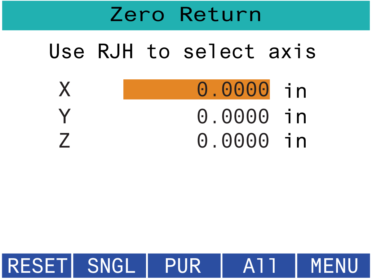

15.5 RJH-Touch XL Zero Return
RJH-XL - Zero Return
To access this function on the RJH-XL, press [ZERO RET] on the control pendant or select ZERO RETURN from the RJH-XL operation mode menu.
Press the axis position on the screen or press [F1]/[F3] on the RJH-XL to change the axis.
Press the [RESET] button on the screen to reset the alarms.
Press the [SNGL] button on the screen to zero return the axis highlighted.
Press the [PUR] button on the screen to command a Power-Up Restart.
Press the [ALL] button on the screen to zero return all machine axes.
