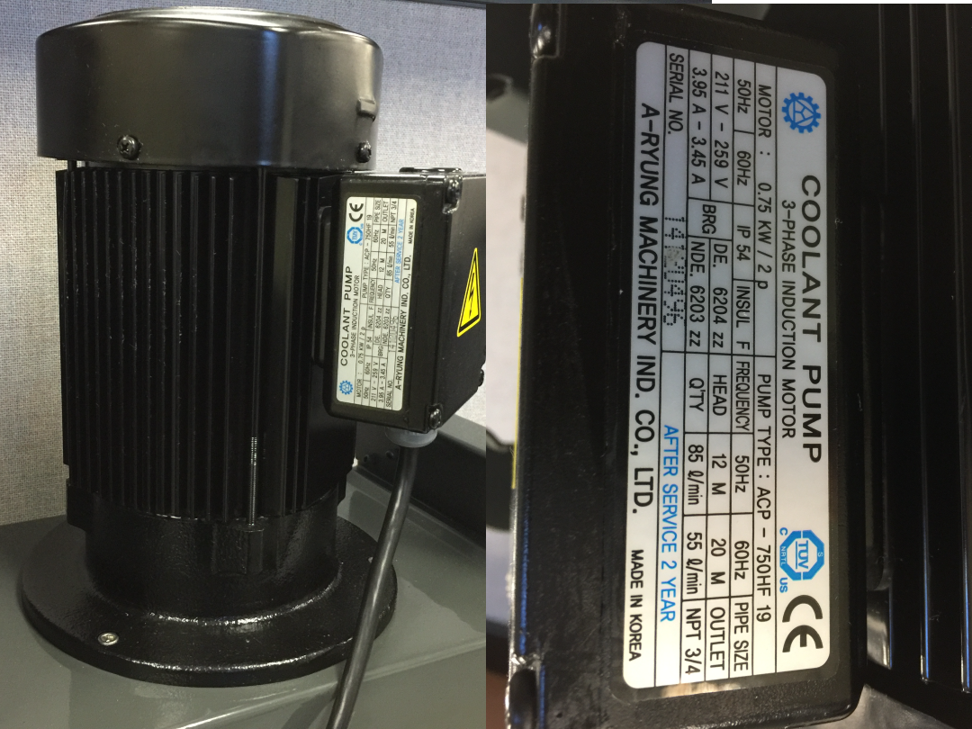

This procedure tells you how to install and shim a replacement impeller on an A-Ryung coolant pump.

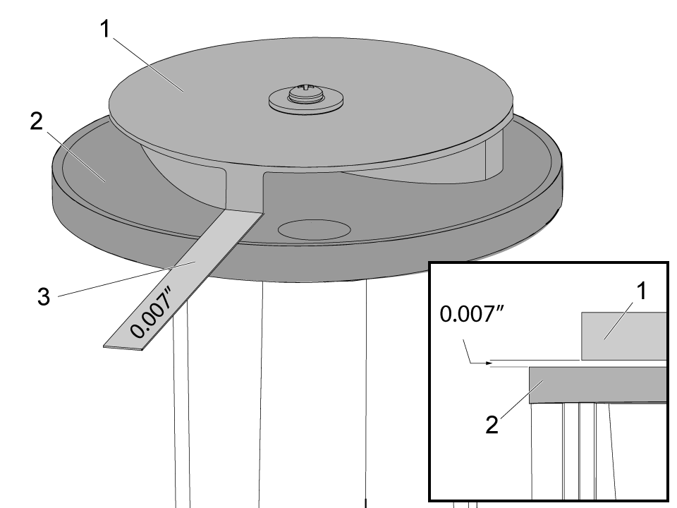

Adjust the number of shims on the impeller shaft until the gap between the impeller [1] and the pump base [2] is 0.007" [3].
Remove the impeller screw and flat washer.
