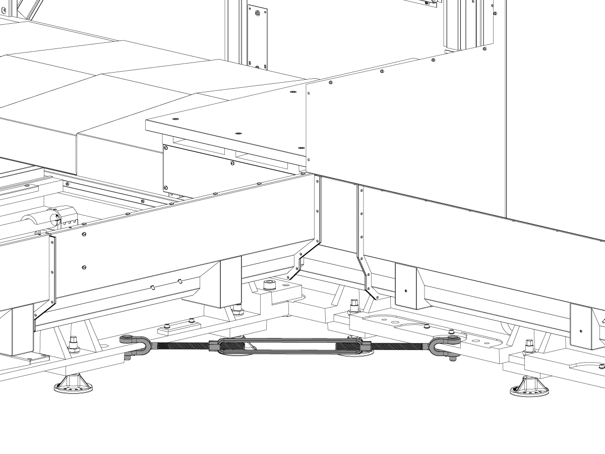

Adjust each leveling screw until the base is 4" (10 cm) above the floor (3" (76 mm) leveling pad height plus 1" (25 mm) of screw below the bottom of the pad).
 Note: The condition of the foundation may require different heights at some leveling screws to make the machine level.
  Important: it is required that the machine be anchored. Refer to the following link: ANCHORING INSTRUCTIONS.
  • Using the anchor pattern from Machine Layout to mark the machine location.

Machine Placement
Important: Ensure the anchoring preparations are in accordance with the anchoring instructions prior to setting the machine in place. Image [1] Anchor hole [2] Leveling Pad.
Place the column base assembly in position on the following leveling screws.
  • 1 - 2
  • 4 - 26
  • 6 - 24
Rough level by measuring from the floor to the bottom of the base 3". (4 - 4 1/2 inches for Conveyor Option).
This will ensure that the final leveling procedure will go more quickly and that the coolant tank will properly fit beneath the coolant discharge. Loosely screw the jam nuts onto the leveling screws.
Place the table base assembly in position on the following leveling screws.. When placing the table base in position with respect to the column base, it is important that the two mating flanges be as parallel as possible (vertically and horizontally).
Rough level by measuring from the floor to the bottom of the base 3" (4 - 4 1/2 inches for Conveyor Option).  This will ensure that the final leveling procedure will go more quickly.
After rough leveling, verify that each of the screws are actually engaged in the threads, and that when the column base is in place and the mating surfaces are in contact that each.
Be certain that the connecting screws are still free to rotate (do not leave the connecting bolts tight at this time because the machine still must be final leveled and squared).

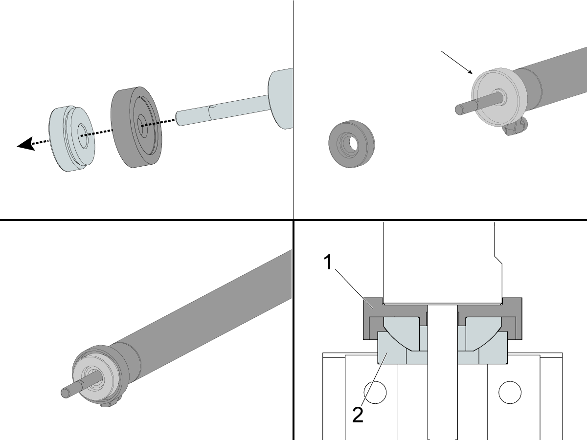

INSTALL COUNTERBALANCE CYLINDER
Note: The counterbalance cylinders have been removed (for overhead clearance during shipping), and they must be reinstalled and recharged with dry nitrogen prior to enabling the column axis.
Re-install alignment collar and spherical thrust bearing.
  • Note orientation of alignment collar[1] and spherical thrust bearing[2] - deep shoulder faces rod end.
Insert the cylinder down between the spindle head casting and Column casting.
Slide the top of cylinder into the Rod Bracket until the bottom clears the Mount Block.
Install cylinder assembly into mounting block on column.
From the rear of the Column casting, extend cylinder rod and re- connect to the Rod End that is mounted on spindle head.
WARNING : Use appropriate PPE equipment (face shield, gloves, etc.) when filling the hydraulic tanks.
Make sure all tank valves are closed before beginning.
Attach nitrogen tank fill nozzle.
Begin filling counterbalance tank by SLOWLY cracking open the valve.
Fill tank until gauge reads 750psi.

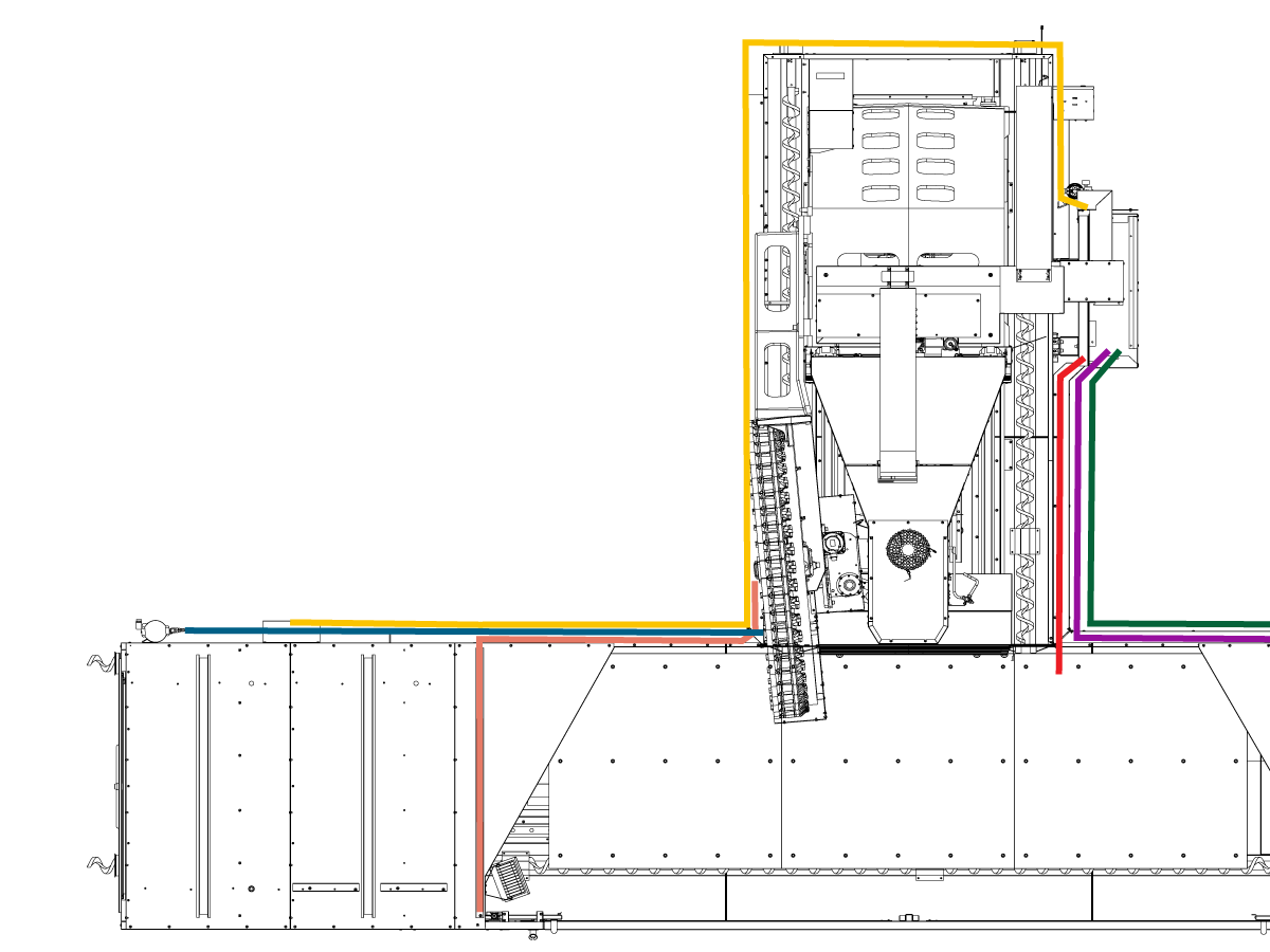

Wiring the Machine
Updated
Wiring the Column Base
  • On the electrical cabinet side, Locate the bundle of wires (Purple Line) containing
    • Right Door sensor cable
    • Air line (Right Door Interlock)
    • Right Side work light
    • RJ45 SHIELDED CABLE
    • USB 2.0 CABLE
    • CBL740/770/+12V&GND-SKBIF EXT VS
    • Work light
  • Route cable through the cable channel along the base of the Column and Table assembly.
  • Continue up the rear panel of the table assembly and over the top of the enclosure in the cable channel.
  • Connect the work light cable to the splitter connector.
  • Insert the air into the right Door Interlock and connect the Right Door Sensor.
  • From the Front Panel, connect the RJ45 SHIELDED CABLE, CBL740/770/+12V&GND-SKBIF EXT VS.
  • Connect the USB 2.0 Male cable [2] to the USB 2 Female w/ Repeater [1] with a loop of 4" and secure the connection with cable ties [3] at each end. See image.
  • Route the Air Line into the front panel and connect to the quick connect for the air nozzle.
Wiring the Column Base (Continue)

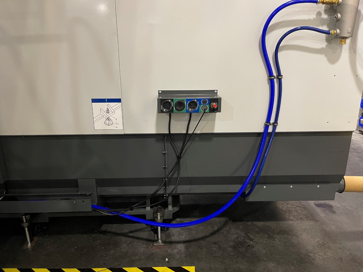

  • On the Tool Changer Side locate the bundle of wires containing
    • Coolant & Conveyor Electrical Connection Bracket (Blue & Yellow Line)
    • Left Door Sensor cable (Orange Line)
    • Air Line (Left Door Interlock) (Orange Line)
    • Left side work light (Orange Line)
  • Route cable and coolant lines through the cable channel along the base of the Column and Table assembly.
  • Split the Door and work light cable from the coolant lines, continue routing the door and work light cables up the rear panel of the Table assembly and over the top of the enclosure in the cable channel.
  • Connect the work light cable into the splitter connector.
  • Insert the air into the Left Door Interlock and connect the Left Door Sensor.
  • Continue routing the Coolant Line and Chip Conveyor Motor Cable through the cable channel and mount the coolant electrical connection bracket to the back of the enclosure panel.
Wiring the Coolant & Conveyor Electrical Connection Bracket
  • Mount the coolant electrical connection bracket and Coolant Filter to the back of the enclosure panel and connect hoses and cables.
Wiring the Table Base
  • On the Table Base locate the bundle of cable (Red Line) containing
    • X - axis motor / encoder cable
    • X - axis Linear Scale cable
    • X - axis lube lines (2x)
  • Route the cables through the cable channel located on the side of the Column base and into the bottom control wire box.
  • In the wire box find the X-axis linear scale interpolation box and connect the X axis linear scale cable.
  • Route the X-axis motor / encoder cable up into the Electrical Cabinet.
  • Connect the X axis motor cable the Amplifier and route the X axis encoder cable up to the Main Processor (P1).
  • Locate the Chip Auger motor cable (Green line) in the cable channel  and route to the electrical cabinet.
  • Connect auger motors to open locaion on QUAD CHIPC  PBC  (P4 - P7).

Two fundamental geometry checks need to be made. The first is the perpendicularity of the X-axis to the Y-axis, and the second is to verify the sweep of the Z-axis.
  • The sweep of the X-axis to the Y-axis is accomplished using a granite square. Set zero by sweeping the Y-axis on one side of the square, and then to verify that the motion of the X-axis is perpendicular by sweeping the adjacent side of the square. If the X-axis and Y-axis are not found to be within tolerance, between the mating flange surfaces that is creating this error.
Observe readings and adjust base to saddle perpendicularity as follows:
  • Install turnbuckle to the side of the base and side of the saddle.
  • Gently tighten the appropriate turnbuckle observing reading changes on indicator.
  • Continue making slight adjustments with the turnbuckles and repeat granite sweeps until perpendicularity reading is within specifications - record readings.
  • Remove the turnbuckles after adjustment.
Note: The turnbuckles should only be used in tension (pulling). If one side of the saddle needs to be pushed, the opposite turnbuckle should be loosened and then pulled from the other turnbuckle. The turnbuckles are only meant for fine tuning of perpendicularity (max 0.020”). The saddle/base need to be rough aligned before using the turnbuckles.
