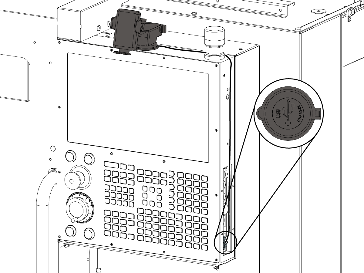

Compatible with machines that have the following pendant versions:
  • 25-1700G - PENDANT ENCL THIN TOUCH
  • 25-1700H - PENDANT ENCL THIN TOUCH
NOTE: To identify if your pendant is compatible with the Haas Charging Stand, pendants must have a USB port located in the bottom with a USB Charger Cap [1] as shown in the image.

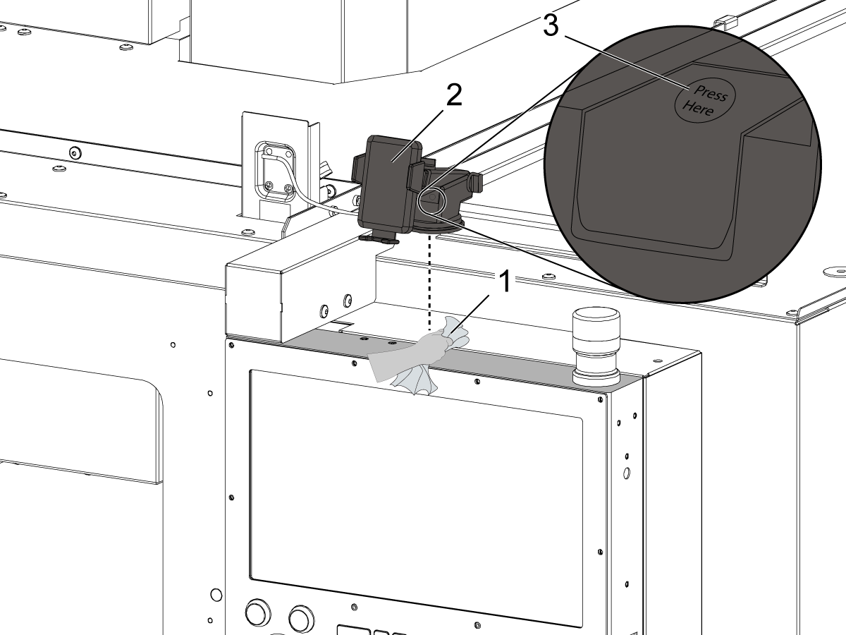

Clean the surface area with the wipe [1] provided to remove any contaminants to ensure good suctioning.
Place the Charging Stand [2] on the recommended area on the pendant as shown in the image and press the tab down [3] so it suctions to the pendant.
Verify that the nut on the back of the Charging Stand is tightened.
To relocate the Charging stand, pull on the tab [3] to release the suction.

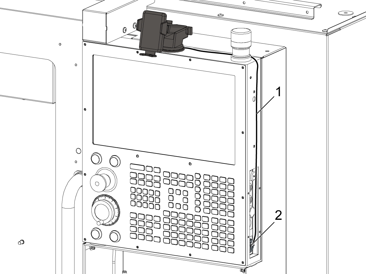

Route the cable [1] from the Charging Stand as shown in the image.
Connect the USB to the USB port [2] as shown in the image.

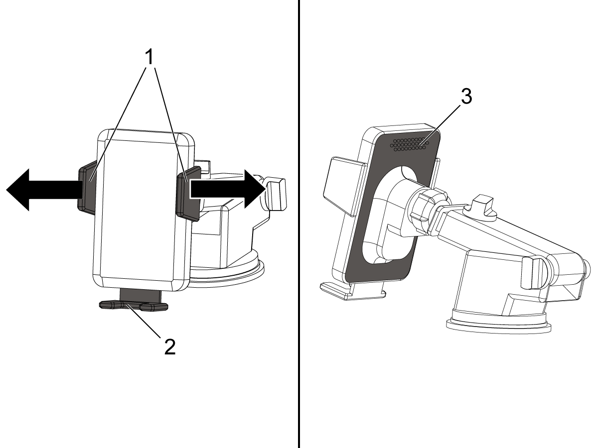

To verify if the Haas Charging Stand is working, place a phone 3.9" (10 cm) from the the charging stand to see if the clamping arms [1] open with autorecognition. Place the phone on the suport feet [2] and the clamping arms [1] will automatically close.
Check to see if the phone is charging.
To release the phone from the Haas Charging Stand, tap the top back of the touch-sensitive region [3] as shown in the image.
