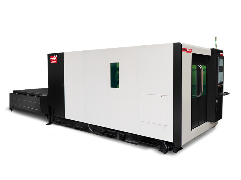

The Haas HFL-3015-3-CE is a fully enclosed 3 kW CNC fiber laser cutting machine with a high-speed autofocus sensor head and a large work area. The unit has dual shuttle tables that exchange automatically, allowing raw material and finished parts to be loaded and unloaded on one table, while the other table is in the machine, providing near continuous operation.
The 3 kW fiber laser cutting head is optimized to provide excellent cut quality and high efficiency, and features automatic focusing to reduce set-up time and increase accuracy. The laser easily cuts a variety of metals, including carbon steel, stainless steel, aluminum alloy, brass, copper, and even titanium alloy.
Haas HFL Series lasers carry a full 1-year warranty – parts and labor – with support by your local Haas Factory Outlet.
