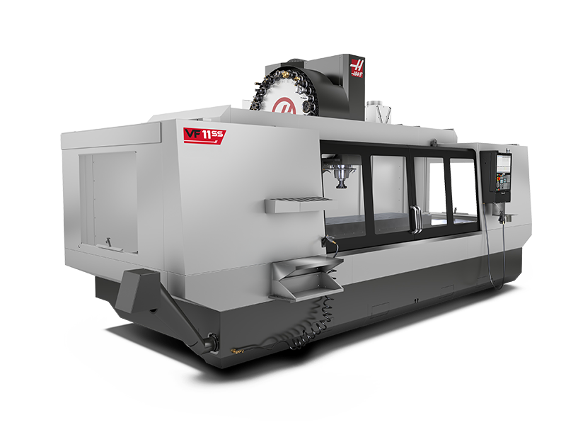

Super-Speed CNC Vertical Mill with 84" x 40" x 30" travels, 50-taper
Haas offers a wide range 50-taper Super-Speed vertical machining centers to match any part size and production requirement. These workhorses are well suited to high material removal rates, no matter what kind of cut you’re taking. And they come equipped with a 12,000-rpm inline spindle and fast rapids for high-volume production and reduced cycle times. The larger contact area of the 50-taper spindle allows the use of longer tools for deep pockets, and larger diameter tools for heavy material removal.
The VF-9SS/50 offers 8" (203 mm) more Y-axis travel than the VF-7SS/50.
  • 12,000-rpm 50-taper inline spindle
  • 30+1 side-mount tool changer
  • Fast rapids in all axes
  • Ideal for tougher materials and larger-diameter cutting tools

    Spindle S.A.E METRIC
    Max Rating 60.0 hp 44.7 kW
    Max Speed 12000 rpm 12000 rpm
    Max Torque 140.0 ft-lbf @ 2200 rpm 189.8 Nm @ 2200 rpm
    Bearing Lubrication Air / Oil Injection Air / Oil Injection
    Cooling Coolant Jacket Coolant Jacket
    Spindle Speed 12000 rpm 12000 rpm
    Drive System Inline Direct-Drive Inline Direct-Drive
    Spindle Power 60.0 hp 44.7 kW
    Full Load Amps (3 Phase) - Low 105 A 105 A
    Full Load Amps (3 Phase) - High* 53 A 53 A
