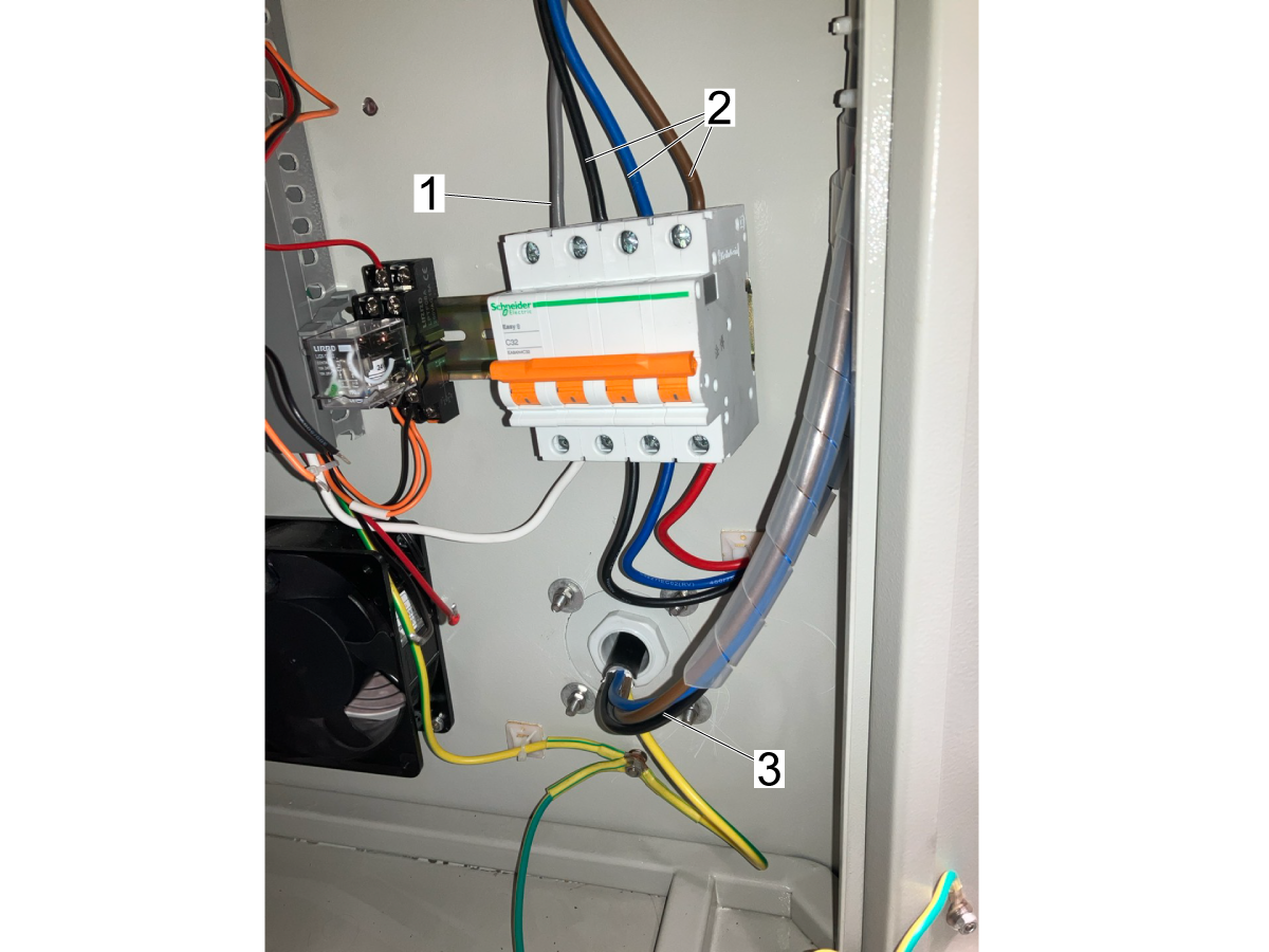

 DANGER: WORKING WITH ELECTRICAL SERVICES REQUIRED FOR A HEAT SHRINK MACHINES IS EXTREMELY HAZARDOUS. ALL POWER TO HEAT SHRINK MACHINES MUST BE TURNED OFF LOCKOUT-TAGOUT AT THE SOURCE PRIOR TO CONNECTING THE LINE WIRES TO HEAT SHRINK MACHINES. HOWEVER, IF THIS IS NOT THE CASE OR YOU ARE NOT SURE HOW TO DO THIS, CHECK WITH THE APPROPRIATE PERSONNEL OR OBTAIN THE NECESSARY HELP BEFORE CONTINUING. ALWAYS USE AN AC VOLTAGE DETECTOR TO CHECK THE INCOMING LINES AND ENSURE THE POWER HAS BEEN DISCONNECTED.
The HSF-450 does not come with a plug installed. We suggest getting a NEMA L21-20P plug or equivalent.
Feed the wire end of the plug into the electrical cabinet. The plug should have five wires:
  • One neutral wire [1]
  • One ground wire [2]
  •  Three 230V wires [3]
Connect the neutral and three 230V wires to the top of the contactor and the ground wire to the sheet metal.
