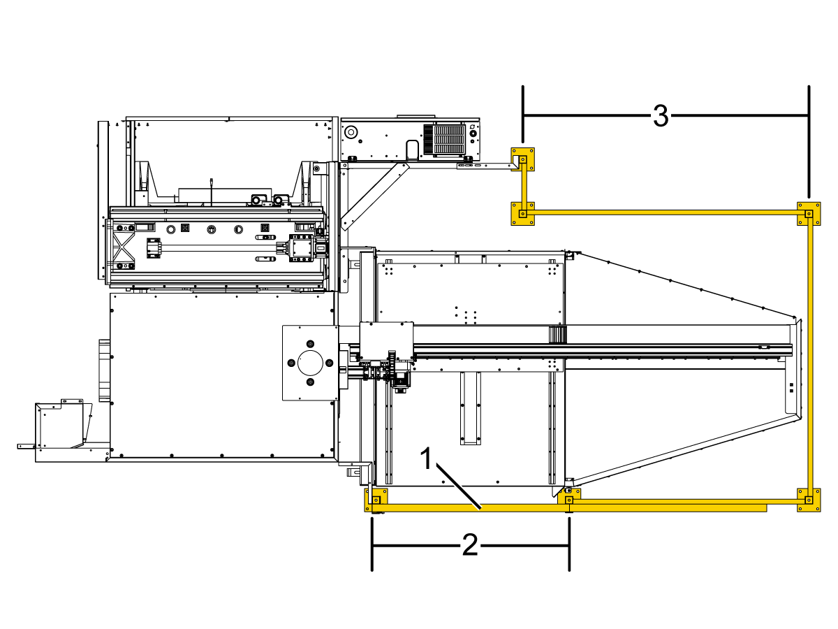

Fence Installation to UMC APL
Refer to this step for APL's built before January 2024
Assemble the fence around the machine as shown. Make sure the door [1] opens and closes correctly.
The door opening [2] is about 70 inches (1778mm) wide and the width of the back of the fence [3] is about 114.125 inches (2899mm).
Refer to this step for CE/Fence APL's built January 2024 and later
The door opening [2] is about 48 inches (1219mm) wide and the width of the back of the fence [3] is about 76.0625 inches (1932mm).
Install the fence panel sheet metal [1] to the machine sheet metal and secure the APL fence [2] to the fence panel sheet metal.
