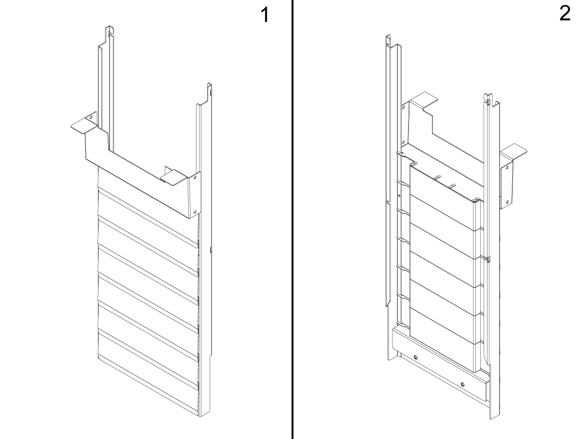

This procedure will show you how replace the Z-axis waycover on the CM-1 / OM machines to the gordillo bellows style waycover.
This procedure applies to the following service kit:
  • 93-3315 WAYCVR KIT Z-AXIS CM-1

Installation
  • Install new bumper from kit.
  • Jog Z-axis all the way up

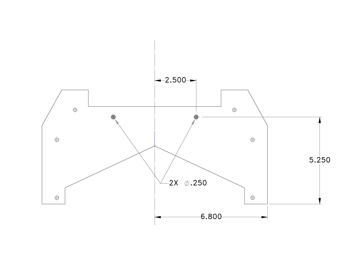

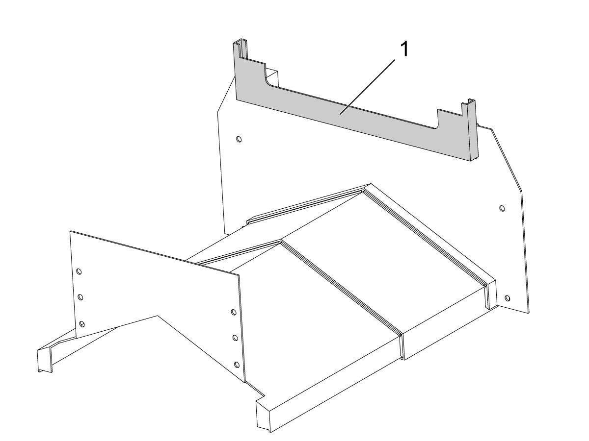

Modify the rear Y-axis waycover back plate.  Remove the lip [1] so the back plate is flat.
Modify the Rear Y-axis waycover back plate.  Drill two 0.250 (6mm) holes as shown in the illustration.
  • Install modified back plate to the Y axis rear waycover.
  • Remove the spindle head cover.
  • (Loosen 4 side screws on back of enclosure for side rails).
  • Install the Z-Axis way cover side rails.
  • Screw back the 4 side screws onto side rails.
  • Install new z-axis way cover sliding into side rails.
