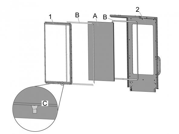

KIT PN: 93-2223, WINDOW, GLASS 39.25” X 29" KIT. QTY: 1

Go into the machine to get access to the inner side of the front door.
Remove the handle from the door [2].
Carefully remove the (4) retainers [1], the old bumpers [C], the old foam tape [B], and the old glass window [A].
Use a scraper to fully remove all of the old foam tape [B] from the door. Clean the areas of all remaining tape.
Cut (1) piece of the new FOAM TAPE [B] to go on each retainer and along the edge of the window opening. Apply the (5) pieces of tape. Make a 3/4” overlap at the ends of the (1) piece of tape on the door.
 Note: Some Windows will have a engraved label "THIS SIDE OUT" on the pane of the new GLASS WINDOW [A]. This label must face the outside of the door.  If the window has no engraving, the window can be installed in any direction.
Install the (14) new BUMPERS [C]. Install the bottom and left retainers [1]. Install the GLASS WINDOW [A]. Install the remaining (2) retainers [1].
Note: The kits include (4) HEX NUTS [C]. Replace damaged or missing nuts on the machine.
