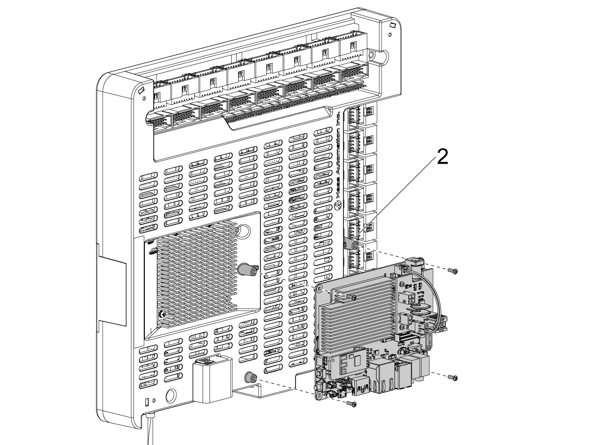

A62 Processor & A62 PFDM PCB Assembly
 NOTE: For machines built before February 25, 2024 that do not have an enclosure on the main processor, use the provided bracket [3] from the service kit to mount the BTD PCB.
Install the A62 processor [2] on top of the mounting plate [3].
Install the BTD A62 PFDM PCB [1] on top of the A62 processor [2].
 NOTE: The battery on the A62 processor is not replaceable.
 NOTE: For machines built after February 25, 2024 with main processor P/N 32-4267 or 32-4269, the BTD PCB bolts directly onto the enclosure [2]. Discard the bracket for these machines.
Install the BTD A62 PCB [1] on top of the processor [2].
Connect the BTD camera cable 79-0159 into the USB adapter 74-2003 [1] that connects into the USB port on the A62 processor.
Connect both LED lights to the +12V LED power cable 33-1228 [2] that goes into J3 on the BTD A62 PFDM.
Make sure that the A62 processor power cable 33-1256 [3] is connected from J26 on the A62 processor to J4 on the BTD A62 PFDM.
Connect the BTD A62 PFDM cable 33-1227 [4] from J2 on the BTD A62 PFDM to J3 on the MAINCON. This cable also has a pigtail that connects to P20 on the PSUP.
Connect the communication cable 79-0158 [5] from the mico USB B port on the A62 processor to the USB port J8 on the MAINCON.
 IMPORTANT: Make sure to insert the translator cable into the lower USB port J8 on the MAINCON.
Add 64-1252 Ferrite filter to the USB extender 74-2003 where it connects to the A62 board.
