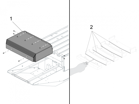

Remove these parts from the machine:
  • Telescopic way cover [1]
    Caution: The way cover has sharp edges. Use the leather gloves when you handle the way cover.
Turn the way cover upside down.
Remove each section of the way cover.
Use the flathead screwdriver to remove the way cover wipers [2].

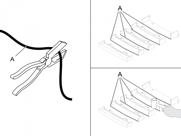

Use the cutters to cut the correct length of each REPLACEMENT WIPER [A]. Make sure the length is the same as the removed wipers.
Install the REPLACEMENT WIPERS [A]. Put Red-I grease on the REPLACEMENT WIPERS [A]. Use the mallet to tap the REPLACEMENT WIPERS [A] into the slots.
