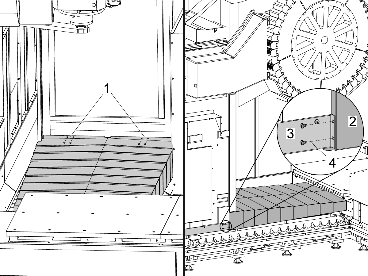

Jog the table to extend the Y - Axis way cover.
Press [POWER OFF].
Set the main circuit breaker to the OFF position.
Lock the main circuit breaker. Use an approved lock and an approved safety tag.
Remove the four bolts [1] on the sides of the way cover [2] that attach it to the Y-Axis casting and the four bolts [3] that attach the way cover to the side rails [4].
 Note: There are four bolts total on each side of the way cover.

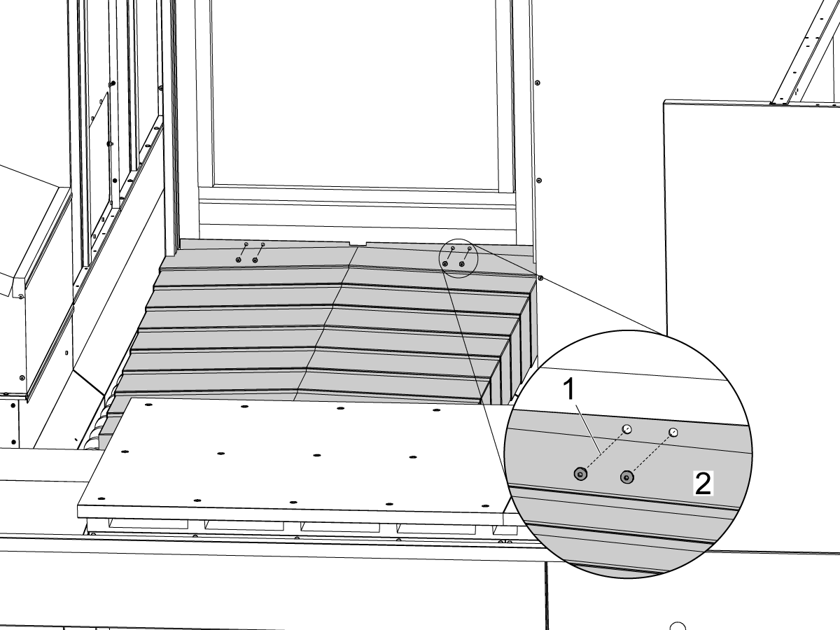

Remove the four bolts [1] connecting the way cover [2] to the column.

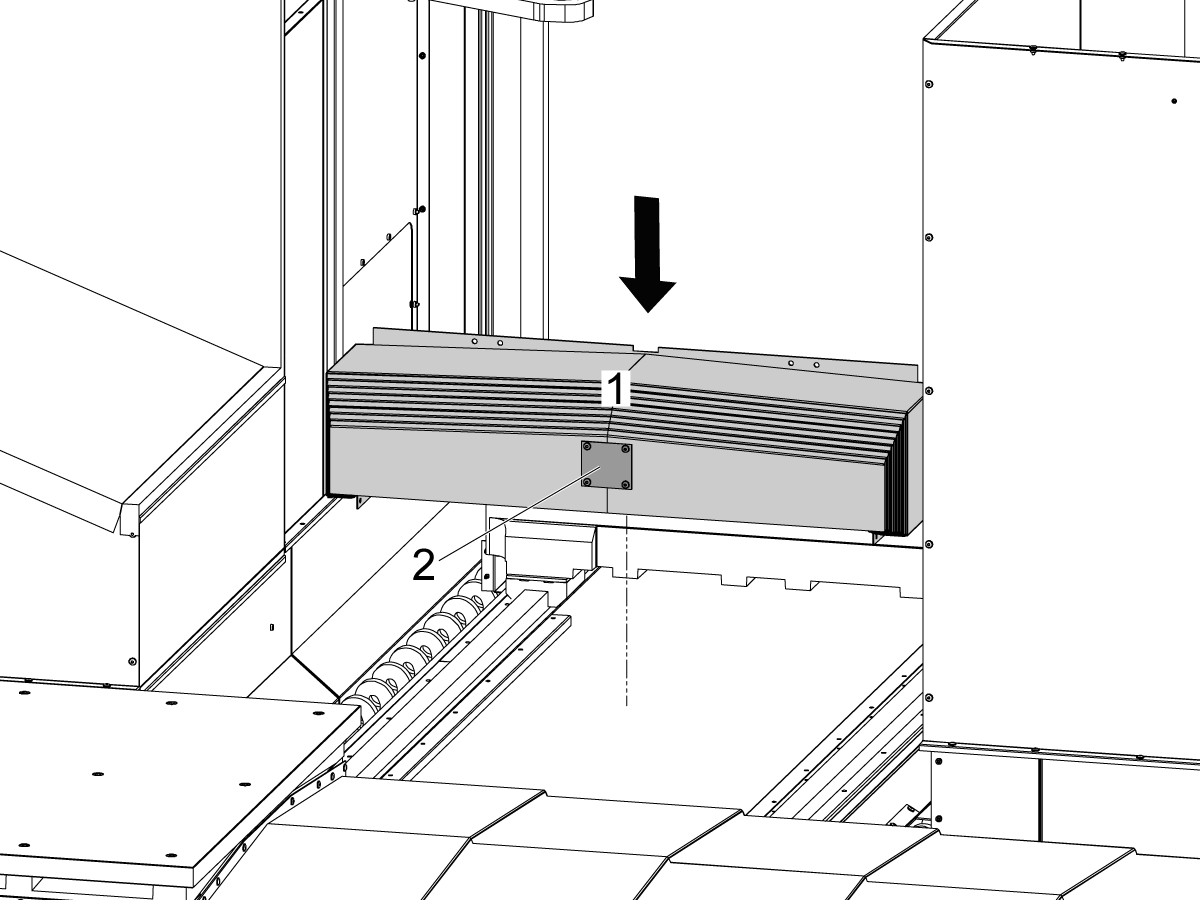

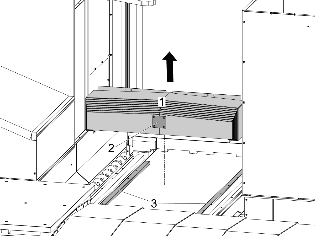

Remove the way cover [1] from the machine.
Remove the access cover [2] on the front of the original way cover and install it onto the replacement way cover.
Remove chips and debris from the linear guides.
Clean the column surface where the way cover will attach.
Apply a thin coat of grease to the way cover guide bars [3].
Install the stainless steel replacement way cover [1] into the machine.
 Caution: Do not let chips or debris to fall onto the ballscrew, ballscrew motor, or guide rail areas.
 Note: Verify the access cover [2] is installed onto the replacement way cover.

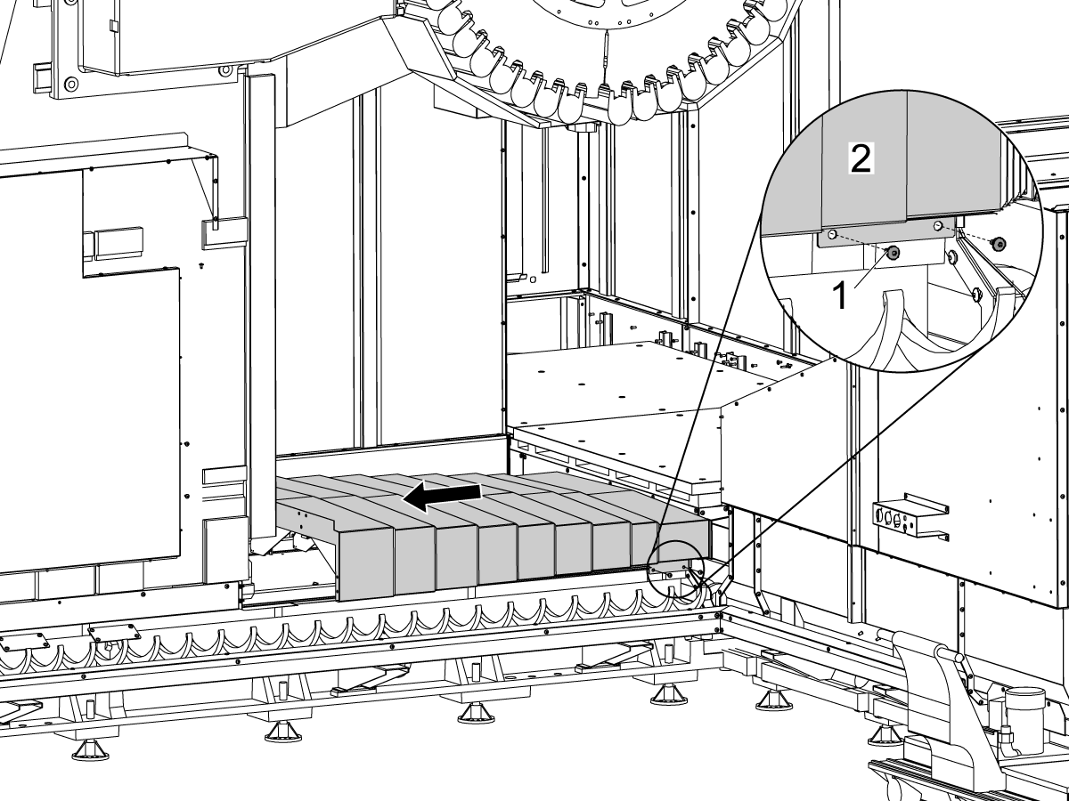

Install unused bolts [1] on the sides of the way cover [2] to attach it to the Y-Axis casting.
Expand the way cover by hand along the guide rails to reach the column.
 Note: There are two bolts on each side of the way cover.

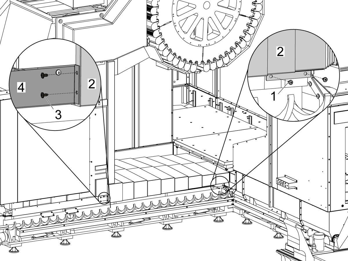

Attach the way cover to the column [1].
Secure the way cover [2] to the side rails [3] with unused bolts [4].

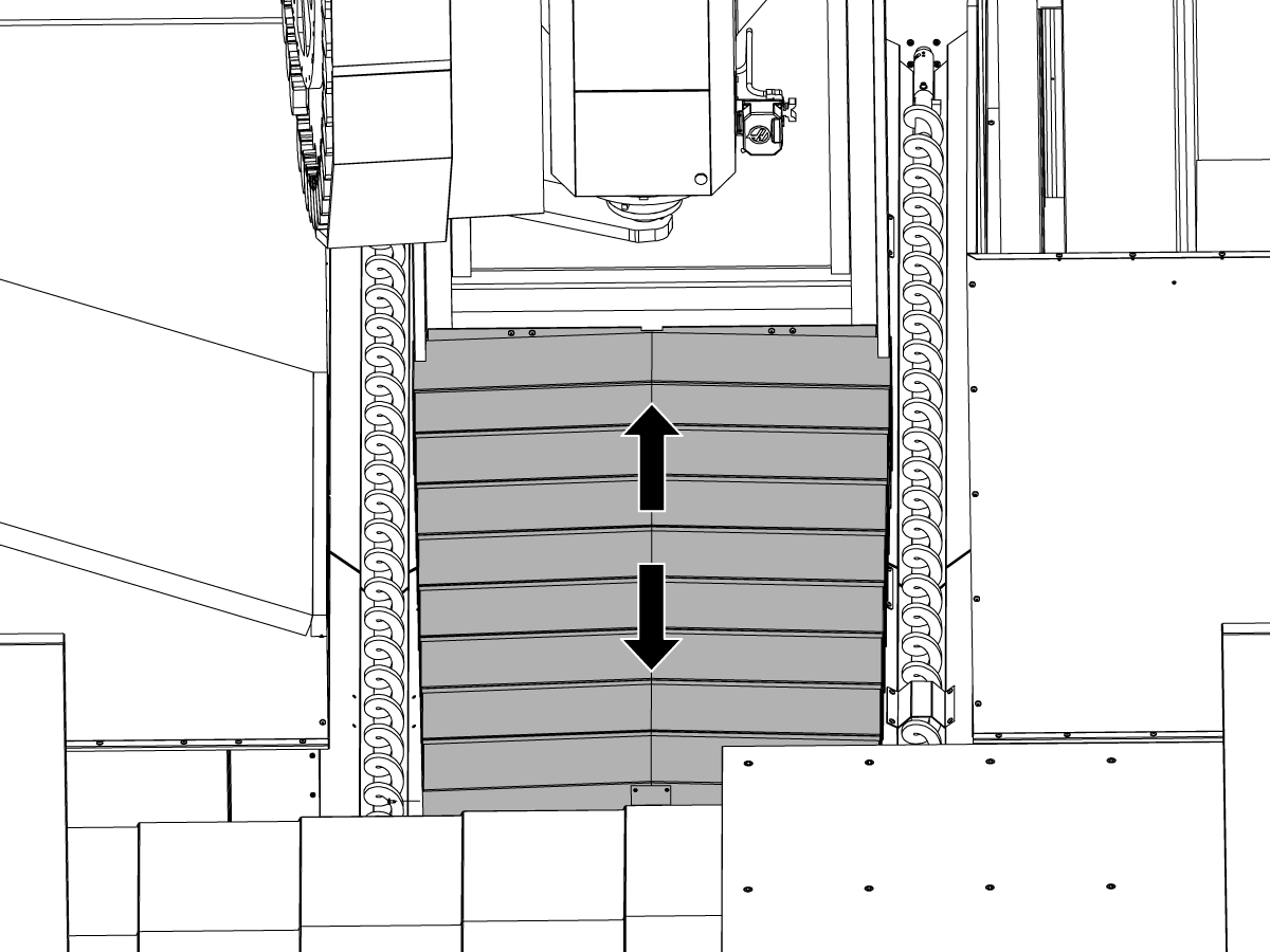

Slowly move table across the full axis travel. Listen for grinding or sounds of impact from the way cover. If these sounds are present, open the way cover and slowly move it along the rails, looking for places where impacts may occur.
Tighten down way cover bolts. Lightly spray a multi-purpose lubricant on the tops and sides of the new way cover panels.
Run way cover back and forth across the full extent of axis travel several times to break it in.
