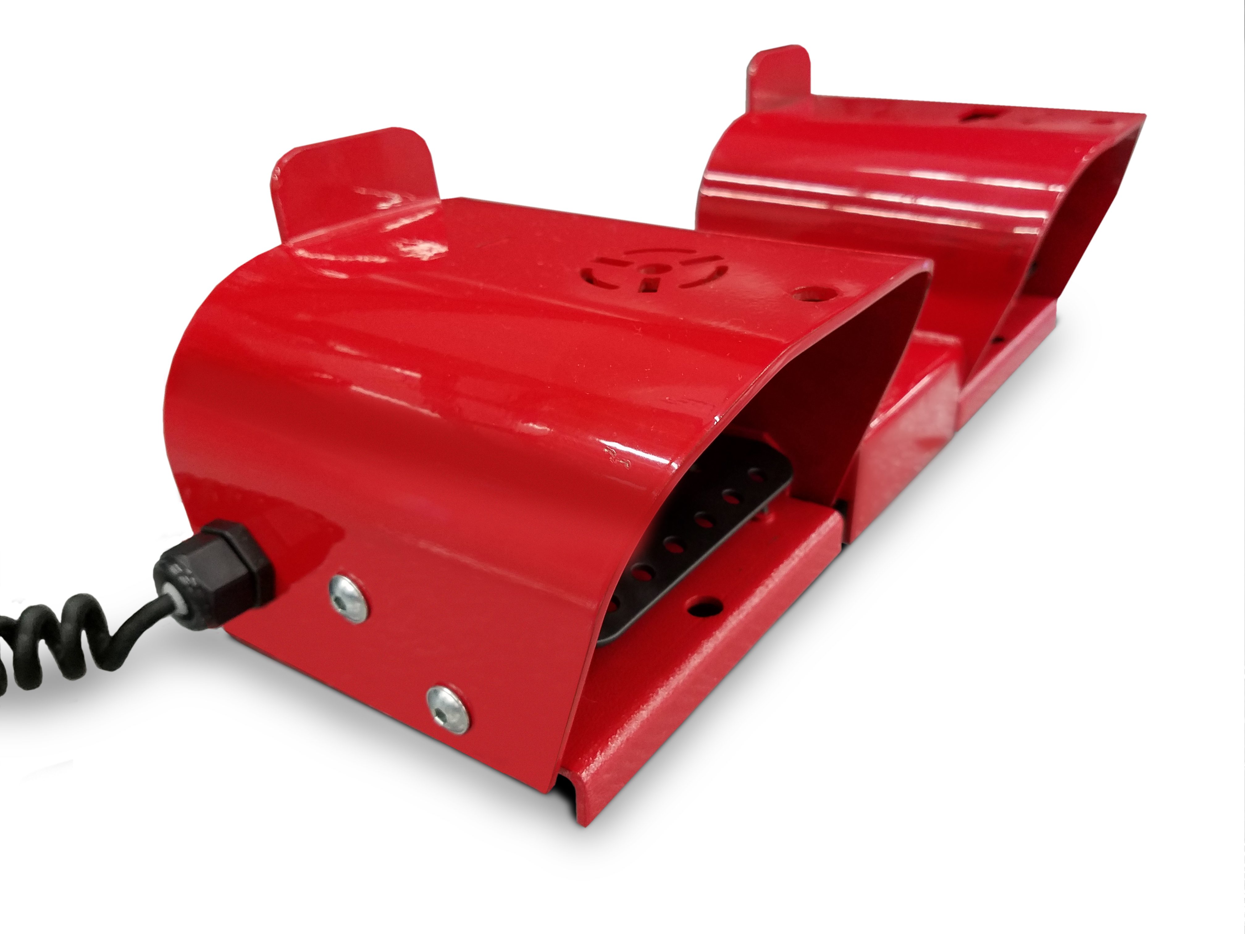

The foot pedals allow the operator to manually perform the following hydraulic functions:
  • Chuck Clamp and Unclamp
  • Steady Rest Clamp and Unclamp
  • Tail Stock Positioning
  • Tailstock Quill Positioning

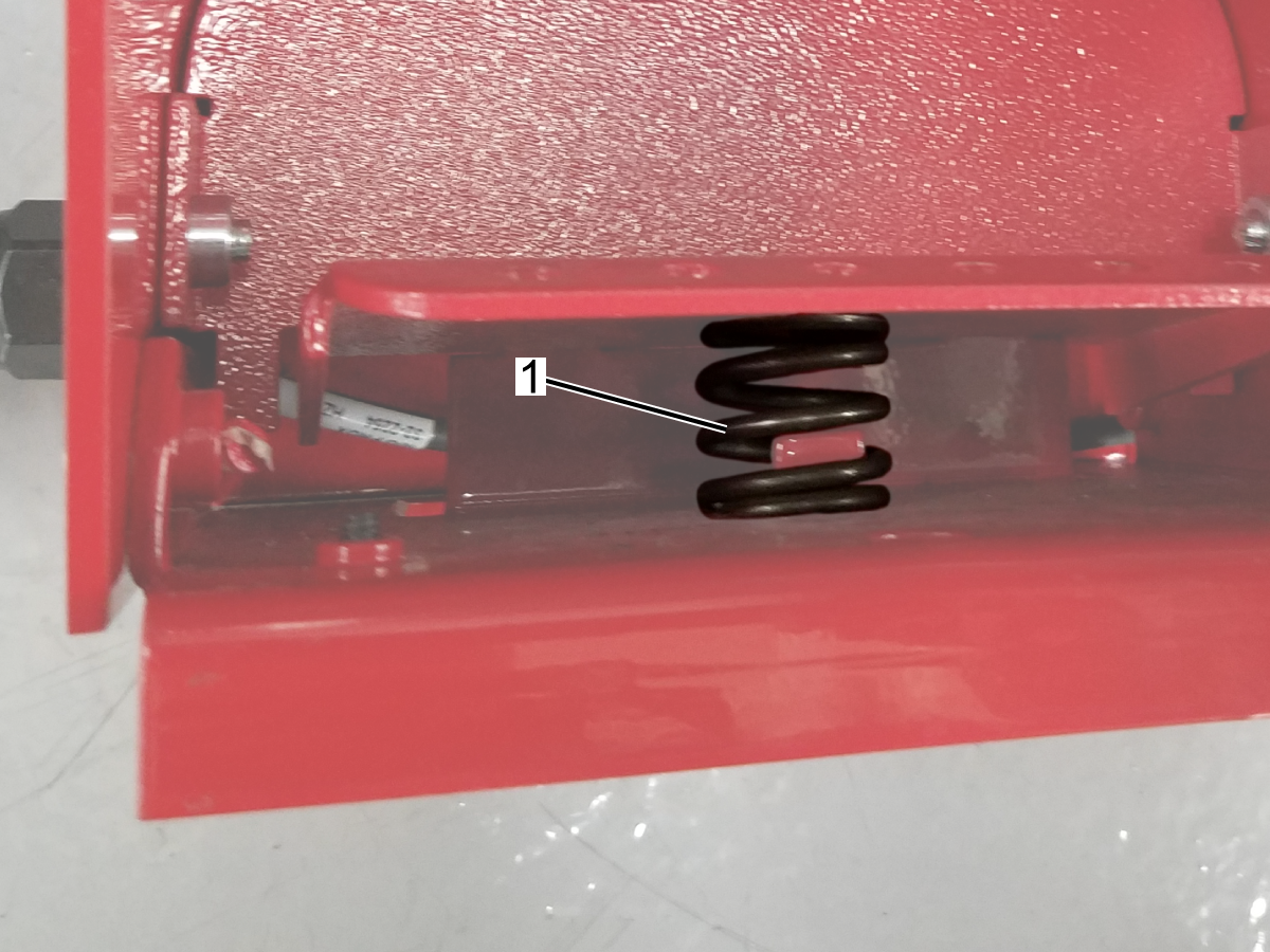

The pedal spring is broken. Check pedal spring

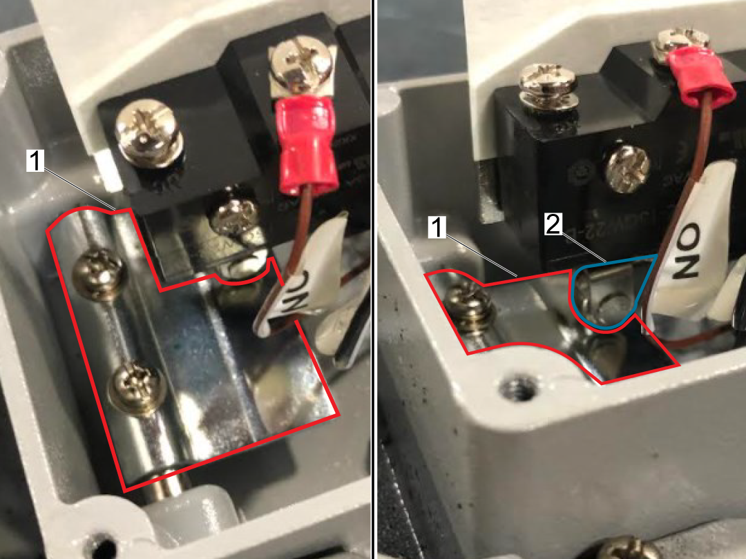

The metal switch flag is not actuating the switch. Check the foot pedal switch flag when the pedal is actuated, make sure the metal flag actuates the switch. See foot pedal flag adjustment section below.

Corrective Action: Check if there are chips in the sensor. Check pedal spring
  • Blow air into the pedal to remove chips in the proximity sensor. If the issue continues open the pedal to check if there are any chips interfering with the sensor.
  • Check the pedal spring [1] and check for tension. Replace if necessary.

To adjust the foot pedal flag push down on the flag [1] until the normally open switch lever [2] fully releases. Press on the foot pedal and listen for a clicking to ensure the flag and switch lever are properly actuating.
