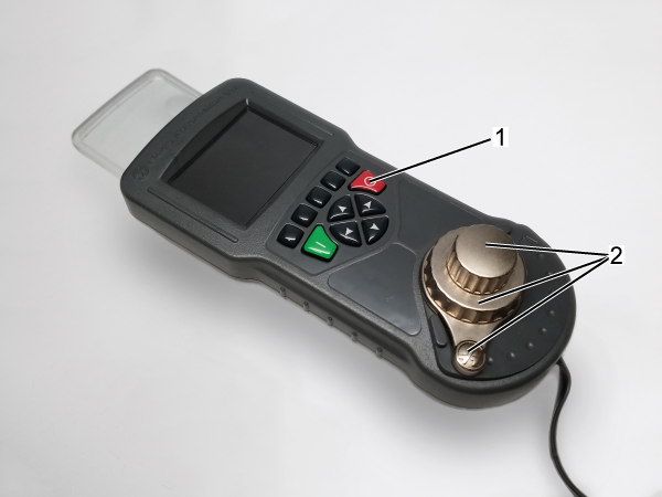

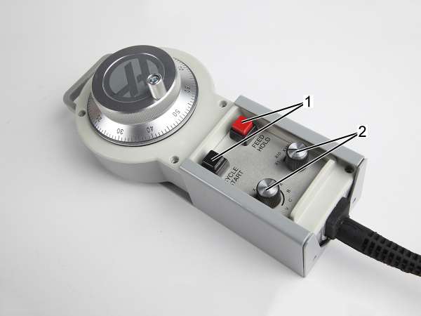

There are three different versions of the RJH: a simple, easy-to-use non-display version [1], a monochrome LCD version [2], and a version with an enhanced color LCD display [3].

Examine the buttons [1] and switches [2] for signs of physical damage or contamination.
If there is no display on the RJH, remove the face plate. Check the continuity of the buttons.
