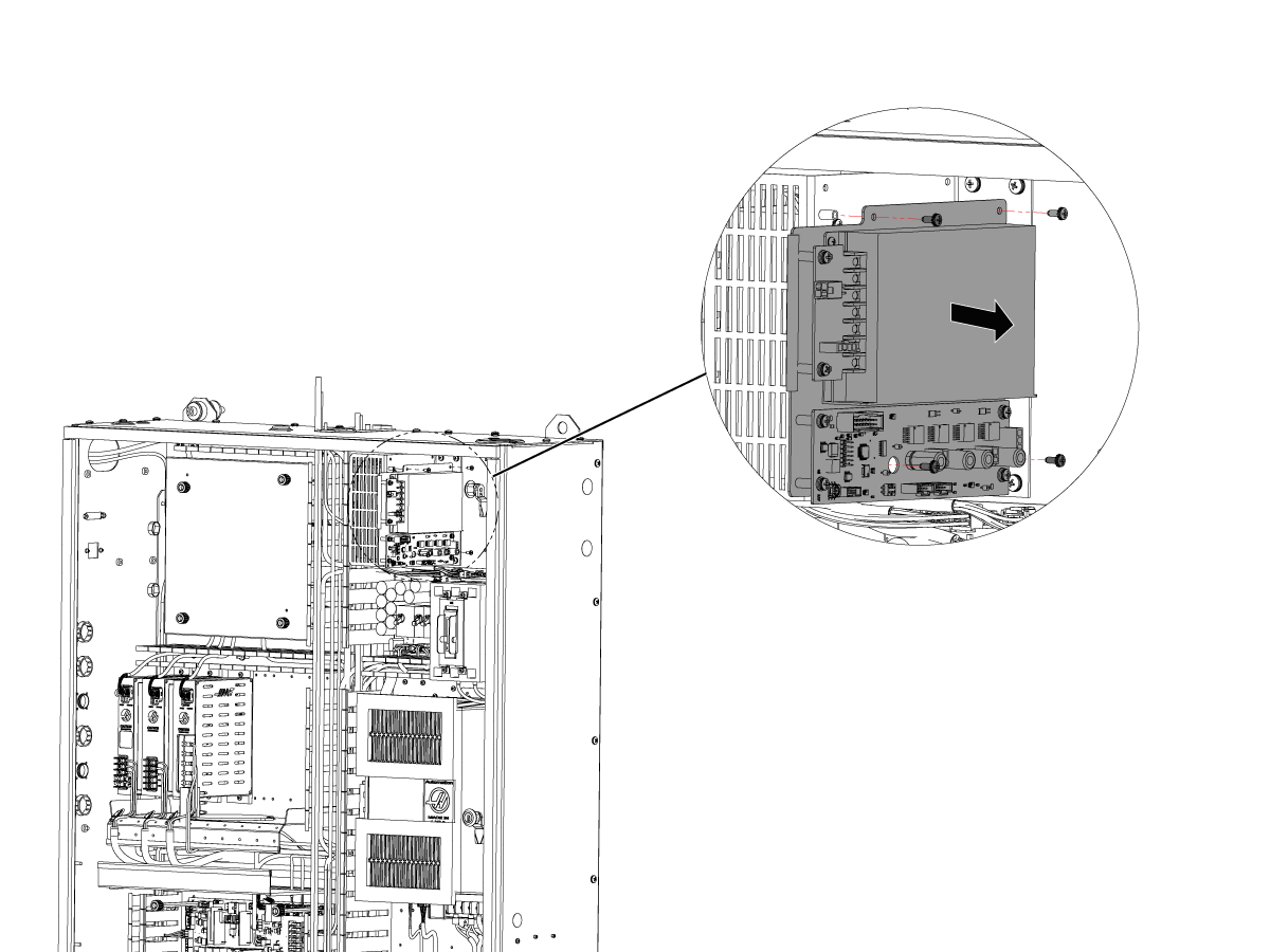

Removal
Set the main circuit breaker to the [OFF] position.
Locate the AD power supply that is located near the main circuit breaker.
Remove the cables that are connected to the power supply.
Remove the (4) screws from the mounting plate.
Remove the the power supply.
Smart CAN Autodoor Power Supply
Install the Smart Can Autodoor Power Supply using the provided hardware.
Refer to the following for the 350W Power Supply Upgrade:
  • For machines built before July 2021, use the provided (2) 6-32 nuts on the two holes at the top of the LVPS bracket to install the 350W CAN Autodoor Power Supply.
  • For machines built after July 2021, the LVPS should have (2) pem nuts [1] on the existing through holes on the top of the LVPS and the 6-32 nuts are not needed to install the 350W CAN Autodoor Power Supply.
  • Connect the cables to the power supply as shown in the next step.
Connect the Smart CAN Autodoor Power Supply using the wiring diagram shown.
