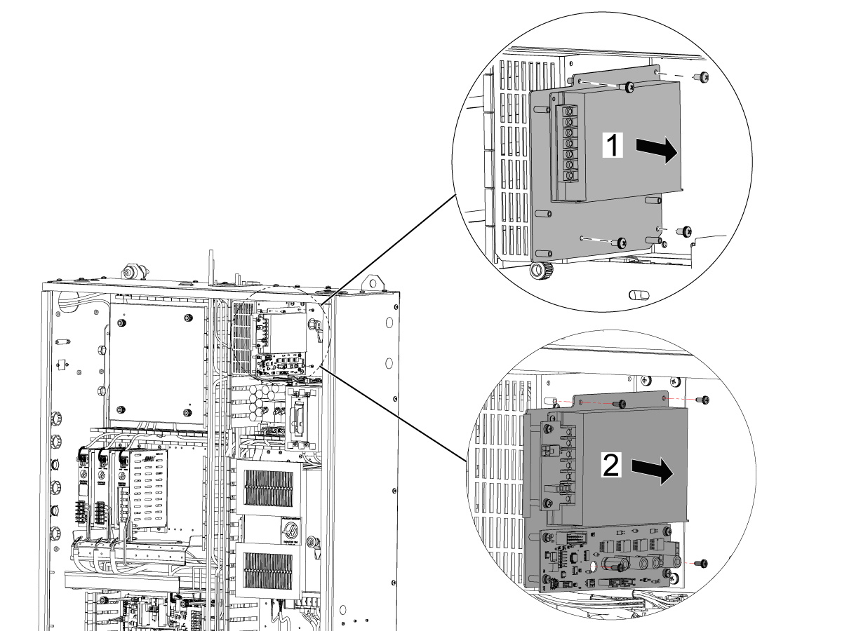

Smart CAN Autodoor Power Supply
Install the Smart Can Autodoor Power Supply using the provided hardware.
For machines built before July 2021: Use the provided (2) 6-32 nuts on the two holes at the top of the LVPS bracket to install the 350W CAN Autodoor Power Supply.
For machines built after July 2021: The LVPS should have (2) pem nuts [1] on the existing through holes on the top of the LVPS and the 6-32 nuts are not needed to install the 350W CAN Autodoor Power Supply.
Connect the cables to the power supply as shown in the next step.
Connect the Smart CAN Autodoor Power Supply using the wiring diagram shown.
Connect the following cables:
  1. P/N 33-3310 Smart CAN Supply (P1) to PSUP PCB (P7)
  2. P/N 33-5310 Smart CAN Supply (J1) to I/O PCB (J2)
  3. The power cable from the Smart Can Supply (J6) to Autodoor Motor #1 and for Mill connect the power cable from (J9) to Motor Autodoor #2.
Note: For CM-1 machines, there is only one auto door motor, so connect J6 on the AutoDoor PSUP to the motor.
 Note: Cables P/N 33-3310 and 33-5310 are included in the new power supply.
Connect the autodoor button to J15 on the SKBIF PCB.

Power Supply Removal
Set the main circuit breaker to the [OFF] position.
Locate the AD power supply that is located near the main circuit breaker.  The illustration shows the possible Autodoor power supplies.
  1. 8M PCB Autodoor power supply
  2. Original CAN Autodoor power supply
Remove the cables that are connected to the power supply.
Remove the (4) screws from the mounting plate.
Remove the the power supply.
