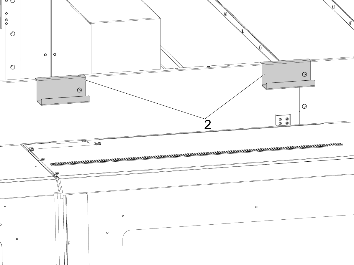

Attach the rail to the sheet metal using the double sided tape provided. Drill 0.159 inch holes in the sheet metal and secure the rail using the provided self-tapping screws.
Note: The image to the right shows the DT/DM/MM/SMM kit which contains 4 self-tapping screws. The CM-1 kit only has 3 screws, but the installation procedure is the same.
 Note: When attaching the rail to the sheet metal, make sure there is clearance for the door to close properly.
Remove the header sheet metal [1] and slide the edge sensor [2] onto the rail.
Reinstall the header sheet metal [1].

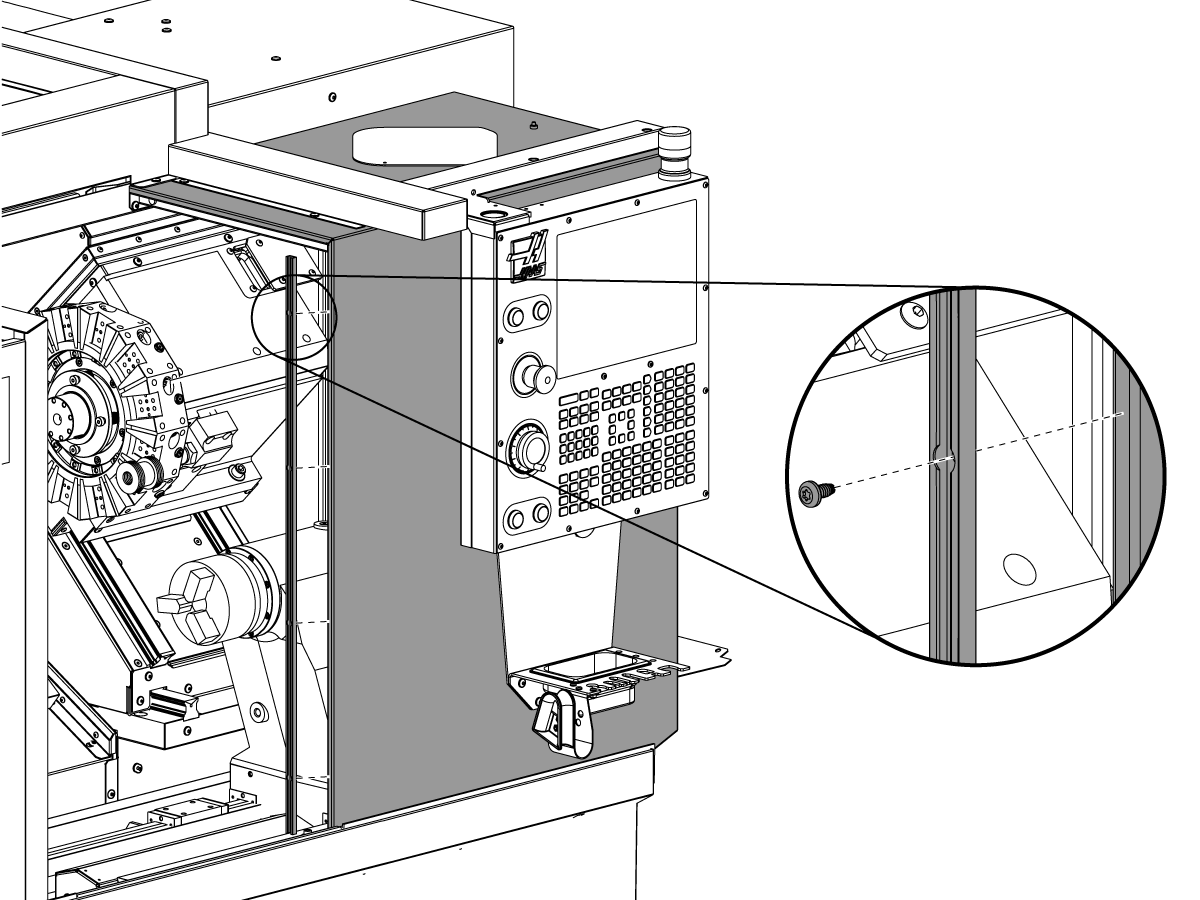

Installation
  • ST-10/15/L use (4) 10-24 PHCS (PN: 40-0192)
  • ST-20/30/L/40 use (5) 10-24 PHCS (PN: 40-0192)
  • DS-30Y (Reboot) use (5) 10-24 PHCS (PN: 40-0192)

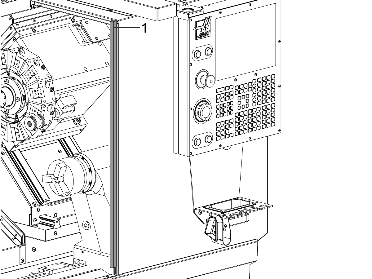

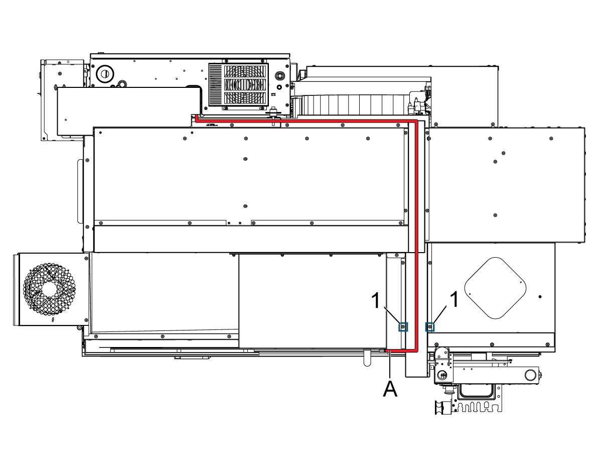

Slide the edge sensor [1] onto the rail.
Attach the cable on the edge sensor to cable [A]. Route cable [A] to the electrical cabinet as shown.
The cable part number for cable [A] is as follows:
  • ST-10/15/L: 33-0792
  • ST-20/30 and DS-30Y (Reboot) : 33-0793
  • ST-20L/30L: 33-0794
  • ST-40: 33-1799
Note: The edge sensor cable may be pinched when reinstalling the sheet metal over the cable routing, if this is the case, use washers under the bolts at [1] to relieve pressure off the cable.

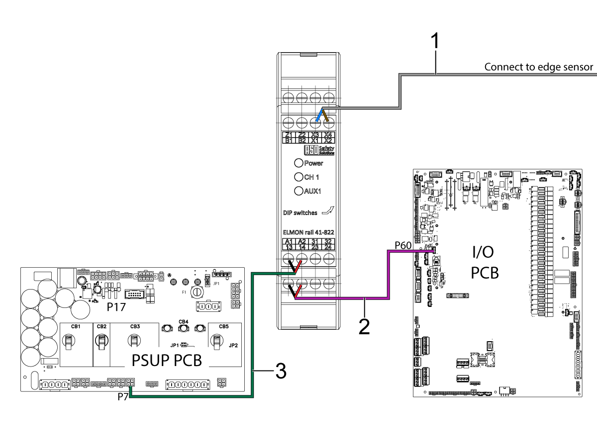

Connect the following cables to the relay as shown in the diagram:
  1. Cable [A]
  2. Cable 33-0797
  3. Cable 33-0601
  • ST-20/30 and DS-30Y (Reboot): 33-0793
  • ST-40: 33-1799
