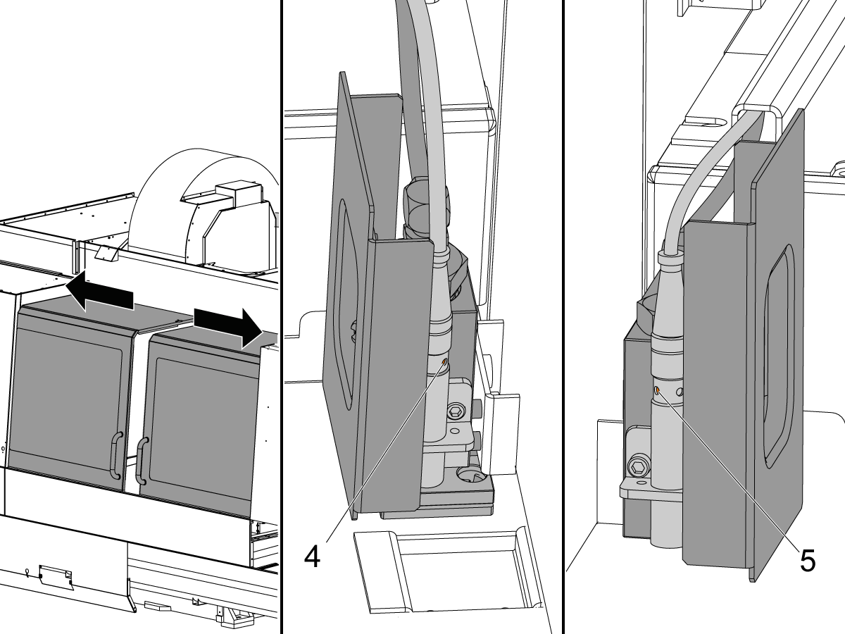

In the image, the cover for the sensor and piston is removed.
  1. Proximity sensor
  2. Piston
  3. Stop block
 Note: The door shown closes to the right. On machines with two doors, the sensor and stop block for the left door are on the left side of the piston.

If the door was removed or any components are loose, the door interlock sensor can become misaligned. Inspect the door rollers and make sure all of the interlock components are aligned.
  • R is 0.0" - 0.09" (0.0 - 2.3 mm). Space R is the distance between the end of the proximity sensor housing [2] and the top of the stop block [3].
  • S is 0.06" - 0.25" (1.5 - 6.4 mm). Space S is the distance between the extended piston [1] and the stop block [3].

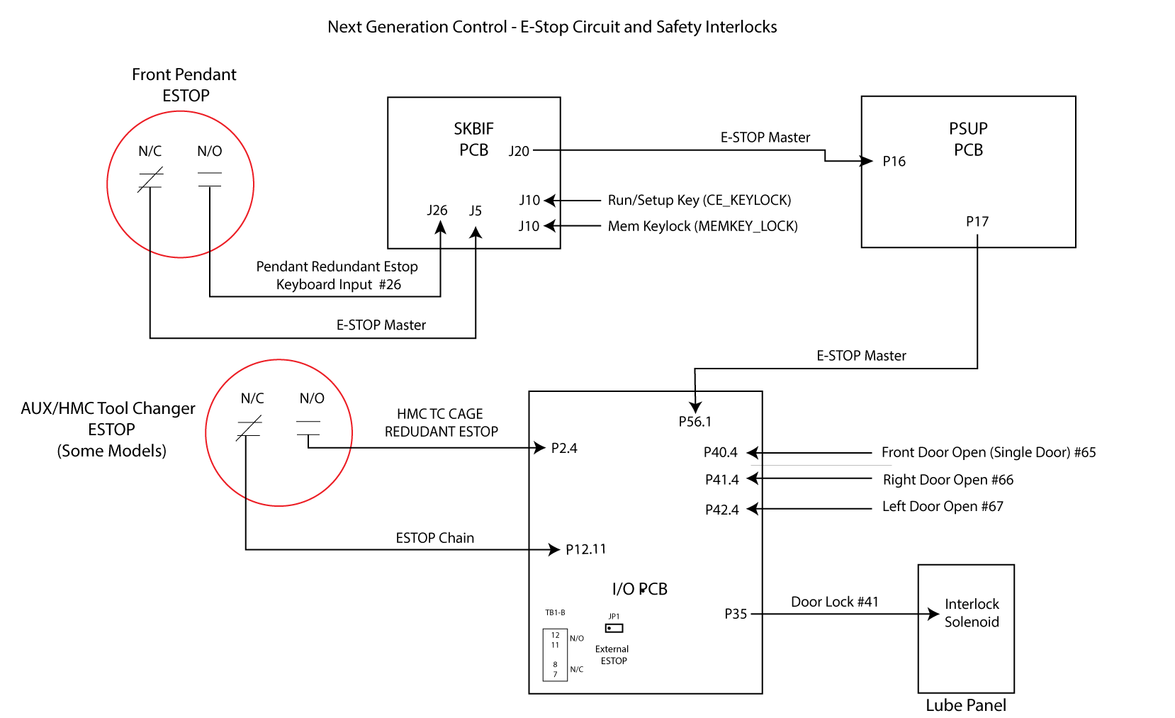

Interlock solenoids use the power-to-lock system.
Command a spindle speed of 100 rpm.
Measure the voltage at the I/O PCB. The correct voltage is 120 VAC. Verify that voltage is present (connectors P29 [1] on a Classic Haas Control (CHC), P40 and P41 [2] on a Next Generation Control (NGC)) when the door is closed and locked. If no voltage is present, go to I/O PCB - Troubleshooting Guide (Classic Haas Control) to troubleshoot the I/O PCB. If voltage is present, test the solenoid. Refer to Solenoid - Troubleshooting Guide to troubleshoot the solenoid.
Set the pendant key to “run”/locked mode. Close the door. Make sure the sensor indicator lights [4,5] activate. If the sensor lights fail to activate, the sensor may be defective, misaligned, or have a faulty connection. Refer to Sections 1 and Proximity Sensor - Troubleshooting Guide to troubleshoot the proximity sensors.

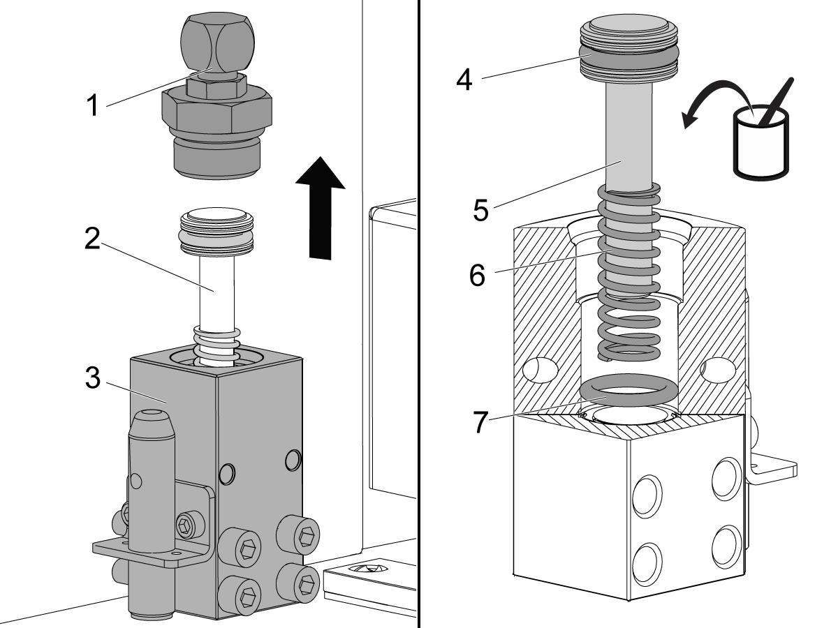

Improper maintenance of the machines air supply can lead to water contamination and Failure of the machines door interlocks.
If the interlock is contamintated, make sure the machine air supply is clean and dry.
Rebuild the intelock per the steps below
Corrective Action:
Remove the upper fitting  and O-ring (59-1997) [1] and the piston assembly [2] from the interlock body [3]. Use a pick to remove the bottom o-ring [7].
Clean the inside of the interlock body and all parts. Replace any damaged o-rings.
Apply a thin coat of silicone grease to the Piston o-ring (59-2218) [4], the piston shaft [5], the spring [6], and the bottom o-ring  (59-2218) [7].
Fix the source of contamination to prevent a recurrence of the problem.
Broken Spring
Corrective Action:
Clean the inside of the interlock body and all parts. Inspect/replace the spring [6], 59-1409.
Apply a thin coat of silicone grease to the piston o-ring (59-2218)  [4], the piston shaft [5], the spring [6], and the bottom o-ring (59-2218) [7].
