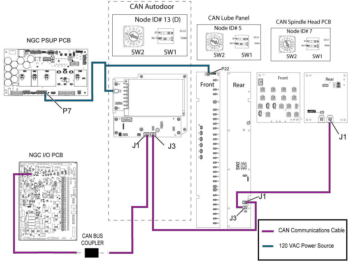

Controller Area Network (CAN) is a robust vehicle bus standard designed to allow microcontrollers and devices to communicate with each other. This method is used to create satellite nodes grouped by function that can be expanded on without changing the core electronics.
  • Each board has a node ID selection switch [SW2] that must be set correctly.
  • Devices are connected in Daisy Chain.
  • Each board has a termination switch [SW1] that much be set correctly.
Note: The last device on the chain needs to be terminated.

CAN Spindle Head & Lube Panel Troubleshooting
Problem: Machines with SW Version 100.21.000.1003 and earlier: Alarm 9899.002: Node ID: XX [0x30] IOPCB CAN FAULT or other 9899 CAN Bus alarms.
Machines with SW Version 100.21.000.1100 and later: Alarm 9702: I/O board reported it lost communication from node CAN code [0x30] or other CAN Bus alarms.
After cycle powering the machine, alarm 9105 IO BOARD COMMAND EXECUTION FAILURE is generated and other I/O & CAN alarms. Analog sensors all read zero.
Cause: Communication between the IO PCB and CAN bus PCB was lost. This can be caused by a communication interruption or because the CAN bus PCB or the CAN power supply has failed.
Update software, IO Firmware, and all CAN devices displayed that can be updated to the latest. If the node is damaged or disconnected it may not display on the list of nodes. All nodes are displayed on the Firmware Updates page[1]. The Spindle Head node is missing from the page[2], indicating that there may be an issue with that node.
After cycle powering with the E-Stop pressed, press reset to restore I/O PCB. Note any CAN or I/O alarms after pressing reset.
Navigate to the CAN Bus Diagnostic page. This requires a service key. Note the status of each node, do the faulted nodes correspond to the node displayed in the CAN alarm. Press F4 to Run Diagnostics.
If a single node at the end of the chain or in the middle of the chain is in a fault state, troubleshoot that PCB.
If two or more nodes are faulted, troubleshoot the first faulted node in the chain closest to the I/O PCB then move to the last.
Access the PCB and check the status lights. Spindle Head PCB LED location[1]. Lube Panel PCB LED location[2].

If the Status LEDs are in a fault state, check the node ID selector and termination. If incorrect, power down the machine and change the node ID selector to the correct node ID and set the termination based on the machine configuration and the CAN devices installed on the machine.
With the machine powered down inspect the cables and disconnect and reconnect cables and CAN Bus couplers.
Power up the machine and check the CAN Bus page and press F4 to Run Diagnostics.
If the faulted nodes are the E-Vise or Auto Door, disable the node and verify that alarms clear.
Warning: Do not disable the Spindle Head or Lube Panel and run the machine. Damage or injury can occur.
Electrical Diagrams
The CAN Lube Panel and CAN Spindle Head PCB diagram with a CAN Autodoor and a CAN E-Vise
The CAN Lube Panel and CAN Spindle Head PCB diagram with a CAN Autodoor and without a CAN E-Vise
The CAN Lube Panel and CAN Spindle Head PCB diagram with a CAN E-Vise, but without a CAN Autodoor
The CAN Lube Panel and CAN Spindle Head PCB diagram without a CAN Autodoor or CAN E-Vise
